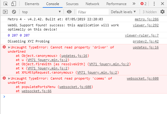

    Only thing I can check: On the PC where it doesnt work, bring up CONTROL,
    Press ctrl+shift+i to open devtools, and click the Console tab - press F5 to refresh the application. Screenshot the window and post here

    see attached screenshot.
  21. Peter Van Der Walt
    Builder Resident Builder
    15,699
    4,510
    Could not connect to the localhost:3000 websocket server... so
    still stands... Something else on the PC may be tying up port 3000/3001, or its blocked by something
    More likely the first, error 400 means there is something responding on port 3000 but its not our websocket server - request was sent to an instance which did not know the given socket id, hence the HTTP 400 response.

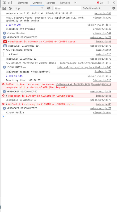

  23. Chris Wailes
    Apr 13, 2020
    15
    Ok, I did it again and this time received some different errors. See attached screenshot.
  24. Peter Van Der Walt
    15,699
    4,510
    Same issue, just at a different time, whatever is running on port 3000 is NOT control, as its not even responding the the VersionAPI

  25. Chris Wailes
    Apr 13, 2020
    15
    Ok I did that and nothing is running on port 8080. However on port 3000 NVIDIA Share.exe is using that port.
  26. Peter Van Der Walt
    15,699
    4,510
    Yes of course, never said to check 8080, told you to substitute from the tutorial... As the tutorial uses 8080, but we want to check 3000...
    So disable/uninstall Nvidia Share then, its conflicting
    Steveathome likes this.
  27. Chris Wailes
    Apr 13, 2020
    15
    Hahahahaha. Sorry, been getting a little stir crazy, my brain is not functioning at full capacity. LOL
    So I think one of my sons installed NVIDIA GeForce Experience which has that Share executable running. I uninstalled it and OpenBuilds is working again. Thank you. It also downloaded the update.
