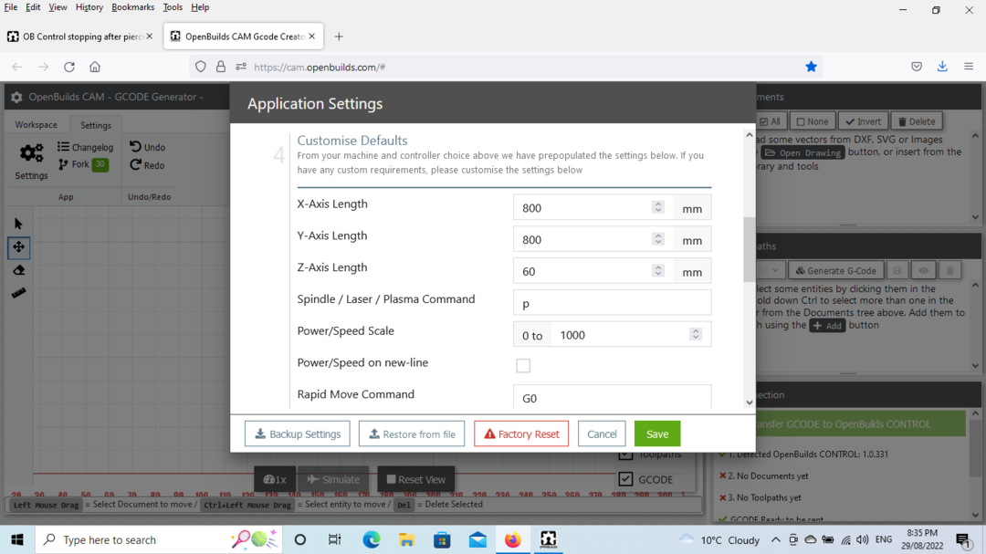

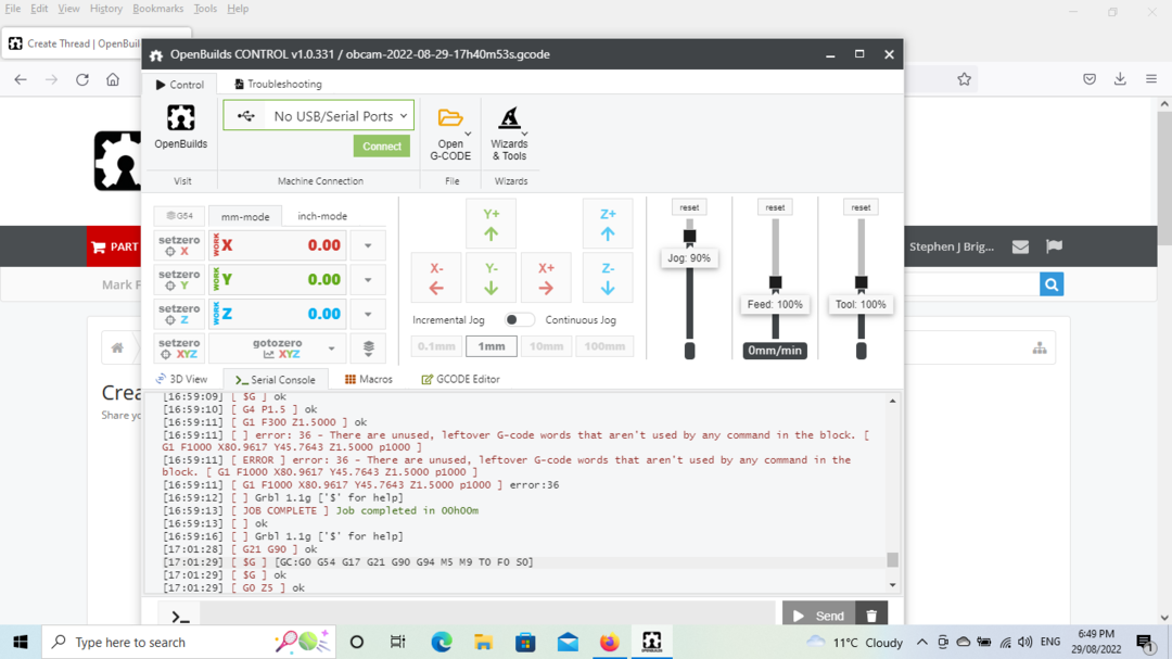

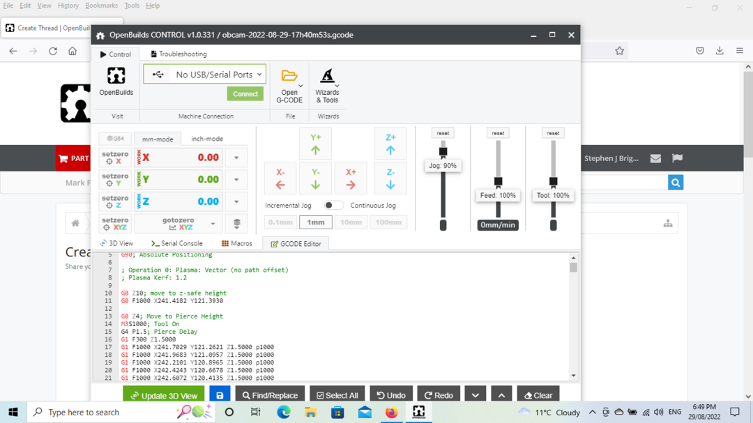

    OB control runs to pierce point with plasma table, pierce is set to 4mm which I have read may be too high,
    pierces and drops to 1.5mm from workpiece then comes up with error code 36
    Files attached . Using OB cam as the G code generator
    I can't work out what p1000 means

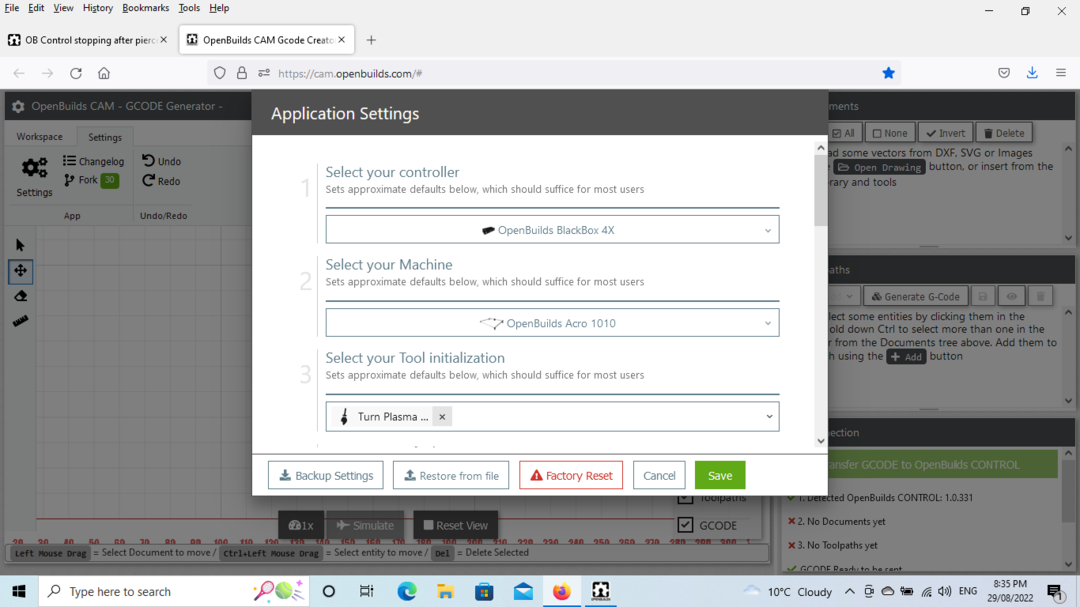

    Post a screenshot of CAM > Settings tab > Settings button > screenshot the settings window including scrolling if it doesn't fit on one screenshot

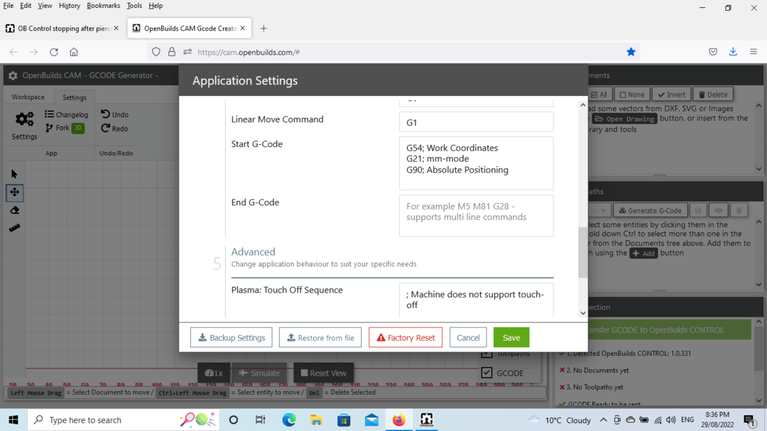

  3. Stephen J Briggs
    Aug 16, 2022
    Thanks for reply attached screen shots
    Builder Resident Builder
    15,700
    4,502

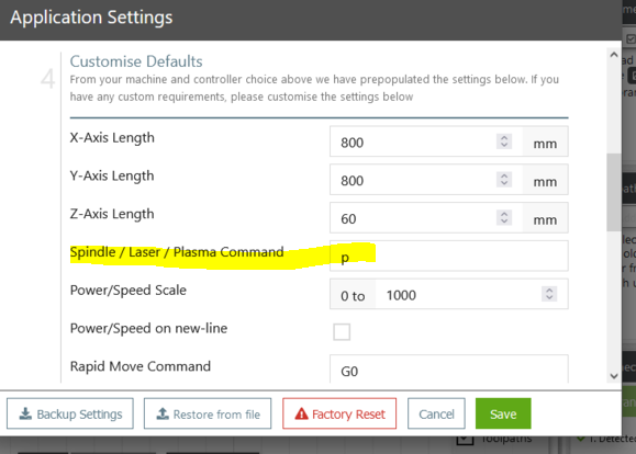

    You changed the Default value from Capital "S" to a lowercase "p"
    Grbl uses the S-Word. Change that back to "S" please
