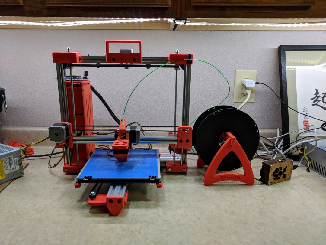

    I finally completed my OneZ! Thanks Keith for this design and assembly instructions. It's printing really well after tuning a bit and retightening everything. This is my first 3d printer and I learned a LOT in the process of building it. I would definitely recommend this design.
    A couple challenges I experienced:
    1) I sent the STL files off to an out of state friend who printed the parts and shipped them to me. The misc-parts-blk.skp file was not present in the STLs and I ended up making a few parts out of wood and zip ties until the printer was functional enough to print out the missing pieces.
    2) The bill of materials does not include a good number of the fasteners. I would read ahead in the instructions and make a list of the screws needed and buy them at the hardware store (US, metric isn't well stocked always). Then as soon as I resumed building it I would find out a couple more that I had missed or weren't explicitly listed. There were many hardware store trips.
    3) The extruder spring needs to be really strong (springy?). I went through a few iterations before I got one that could push with enough force to consistently grip the filament.

    LOOKS GOOD!
    I'm thinking about reviving the OneZ Kits after Jan and will be reworking it, and the BOM then. I agree and apologize that the BOM is incomplete as for screws.
    I'll be moving the PSU off the printer like you did also, but I'm planning on making it the spool holder also. I love the way you did your spool holder! Great looking!
    I've also fallen in love with a different board, the MKS Sbase and will redesign the board box.

    Thanks Keith! No worries about the screws, in retrospect I should have just ordered a large assortment of M3 and M5s. The power supply is actually a converted old computer ATX supply that I had lying around which is why it's not mounted. Thingiverse ftw for the spool holder :), but now I definitely want it on top of the PSU. I also went with separated electronics in a kit (arduino mega, ramps board, stepper drivers, lcd), don't ask how they are mounted in the brains box. I realized belatedly that RAMPS 1.4 doesn't support 1/32nd stepping, but at 1/16th and adjusted steps / mm in the firmware everything is working properly.

    I particularly like the hue of orange filament you used nspence. What is it? Where can I get it?
  30. nspence
    nspence New
    Jan 11, 2017
    It is "Candy Red" from HH3dplastics.com: 1Kg PLA 1.75mm Candy Red - 8" Spool
