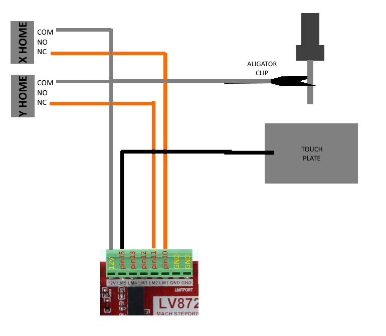

  14. solarground
    May 27, 2015
    61
    Hi to all, hope you are doing fine.
    I am trying to figure out how to succesfully set up the home x and y limits, and how to hook up a touch probe for the z axis to my machine (ooznest ox 750x1000).
    The controller board i use is an LV8727 4axis board and i use mach3. I would like to ask for help if someone could and know how.
    Here is a diagram i tried but i havent experimented a lot, because i am afraid of hurting my board.
    For the home switches i dont know how i have to connect them right, should it be NC or NO? I havent set any machine dimensions yet to mach3,
    i am not sure how to do so.
    For the touch plate i have tried the vb script i found on a youtube tutorial
    and the wiring from another tutorial
    The script runs ok but i couldn't make the close circuit to work, so to detect the router bit touching the plate.
    Any help would be very apprecieted and welcome. Thank you in advance.
  15. SccS
    SccS New
    Jul 15, 2016
    looking at the last diagram you need to connect the switches and the alligator clip to 12v and the NC connectors and the touch plate to LM1 LM2 and LM5
    ok so looking at that diagram i cannot see if its no or nc on the switch,

  16. dddman
    dddman Journeyman
    Mar 2, 2014
    468
    187
    You want to use the NC position on limit switches. If one of your cable breaks, you want the machine to stop.

  17. SccS
    SccS New
    Jul 15, 2016
    Thats the assumption i made looking at the diagram. so the probe setup wont work the way it is as the aligaor clip and plate method relies on the NO setup. ie you complete the circuit at the limit,
    solarground likes this.

  19. SccS
    SccS New
    Jul 15, 2016
    limit switches are correct but the probe wont work that way on that controler
  20. SccS
    SccS New
    Jul 15, 2016
    i think this would work with that board.
    use a relay to break the 12 circuit when the tool touches the plate
  21. solarground
    May 27, 2015
    61
    @SccS thank you very much that was very helpful and clear! I will try this as soon as and i will post about.
  22. SccS
    SccS New
    Jul 15, 2016
    its very basic but will mimic a switch, the other option is to use a switch instead of a plate to set the bit at a specific height above the work,
    for example if you use a microswitch that when closed measures 20mm you can then use that to set the z to 20mm above the work surface everytime.
    excuse the photoshop knock up but you should get the idea.
    make the block say 25mm high, fit the switch inside the block with enough of switch protruding so that when the block is pushed flat to the surface the switch activates,
    Use the COM and NC contacts if you need a break to trigger limit and COM and NO contacts if you need a make to trigger.
    should work
  23. solarground
    May 27, 2015
    61
    Hi, here is what finally worked for me.
  24. dddman
    dddman Journeyman
    Mar 2, 2014
    468
    187
    You just have to invert the input in Mach3 to be able to use NC switch connections
