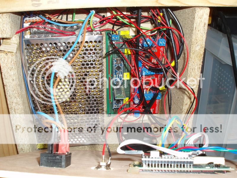

  17. OldDogSleeping
    Oct 22, 2015
    It's been almost a year since I got my Ooznest OX, so I thought I post an update and go through some of the mods I've made over the year.
    The machine has been great, the only mechanical issue I've experienced has been the grub screws coming loose on one of the motor pulleys.
    The first mod is the lowered spoil board; I achieved this by moving the support rails out the side as far as they would go, and dropping the board onto a timber frame sat between the original aluminum supports.
    This has given me plenty of space for the sheet materials I generally cut, but If I need more I can easily swap out the wooden frame for a shorter one.
    Ive added limit switches, at both ends of the X&Y
    but only the top of the Z
    I use them for homing, and while they work fine as hard limit switches, I prefer to use the GRBL soft limits.
    In the early days dust was a real problem. The downdraft from my katsu router ( clone of makita rt0700 ) didn't help. So I made a mount with integrated baffle & dust shoe.
    It's pretty good now, and seems to keep the dust contained even without a vacuum attached.
    You can also see the speed sensor for my PID router speed control. I was having real problems cutting acylic without melting, and traced it down to spindle speed. The routers claimed 10000-30000rpm, turned out to be 18000-36000rpm in reality. So I set about making an external PID speed control (now this was real learning experience!), that allows me to control the speed from 3000-36000 reasonably well.
    I started out with an Arduino Uno and CNC shield, but as part of my aim in building the machine was to learn about motor control electronics. I soon had a more elaborate controller.
    Three Boost DRV8711 modules configured via an Arduino, and a separate Arduino for GRBL + bluetooth interface. I love the huge amount of tuning/configuration options these modules offer, but I'm not sure I'd recommended them to someone who just wants their CNC machine to work.
    Overall it's been a great experience building, tuning and using the machine over the year.
