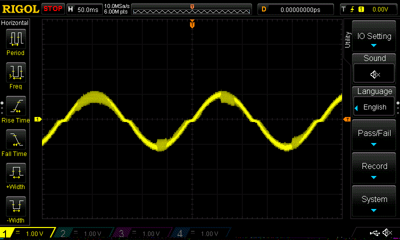

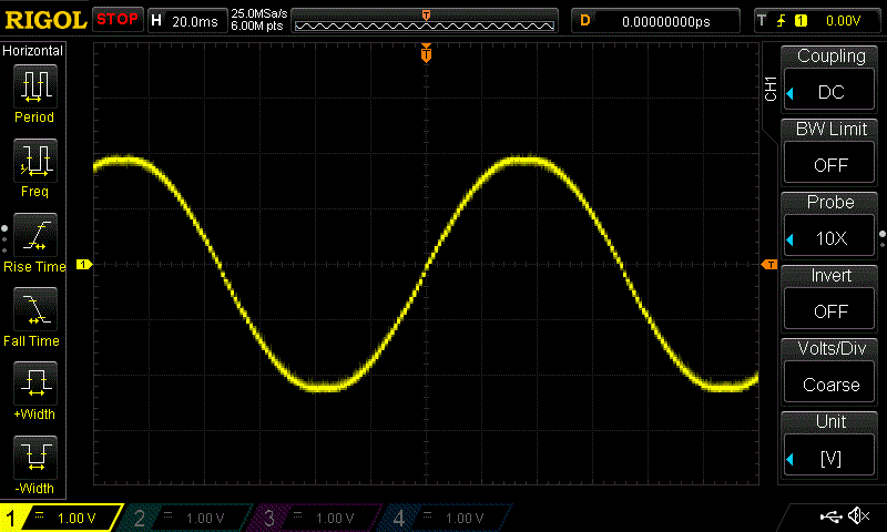

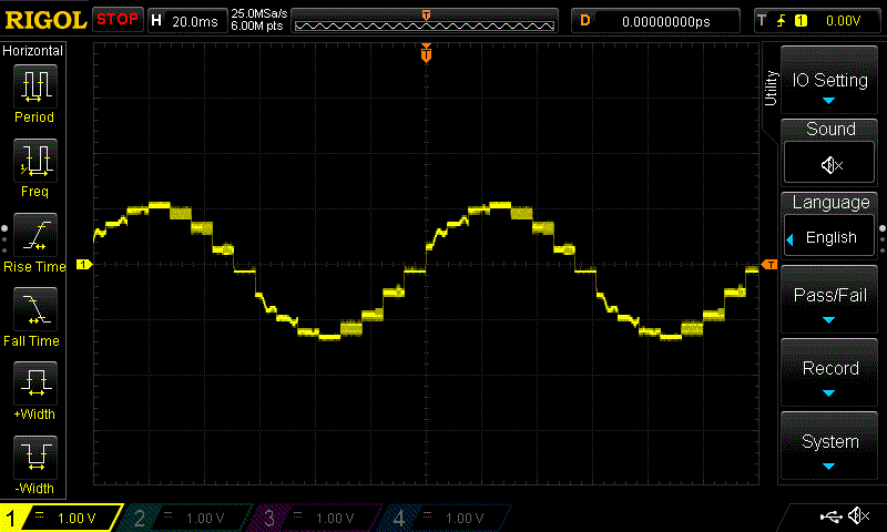

    I have some screen grabs from when I was testing with a current probe.
    These are the current steps at 1/8th Stepping, 12v, AutoMixed Mode (Default), Nema 23 2.8A motor
    This is what happens when things go wrong; 1/32 Stepping, 24v, AutoMIxed Mode
    as you can see the driver is now completely failing to control the current during the increasing steps.
    and how fast-decay helps; 1/32 stepping, 24v Fast-decay mode
    a big improvement, but still not good enough current regulation to make 1/32 stepping worth while.
    I think sticking with 1/8th Stepping, 12v supply, and enabling fast-decay, will give the most stable setup.
    for comparison this what 1/32 stepping looks like using a (much) more expensive driver
