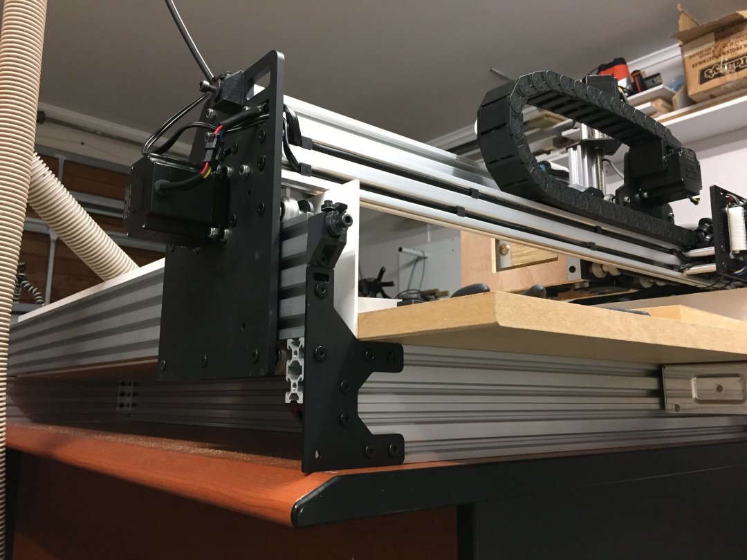

    Getting soooo close to starting this baby up, All that's left is the belts, VFD, Spoiler board and Limit switches. Still have to wire my house for 220v for the VFD but that should be done in the next week or 2. I must say it's been super fun to build. The yellow parts you see are the 3D printed belt tensioners and Drag chain holders.
