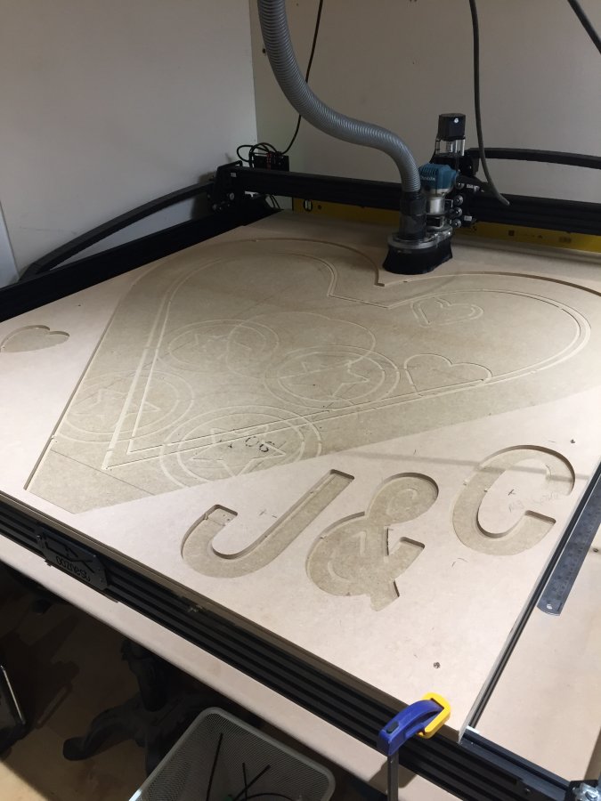

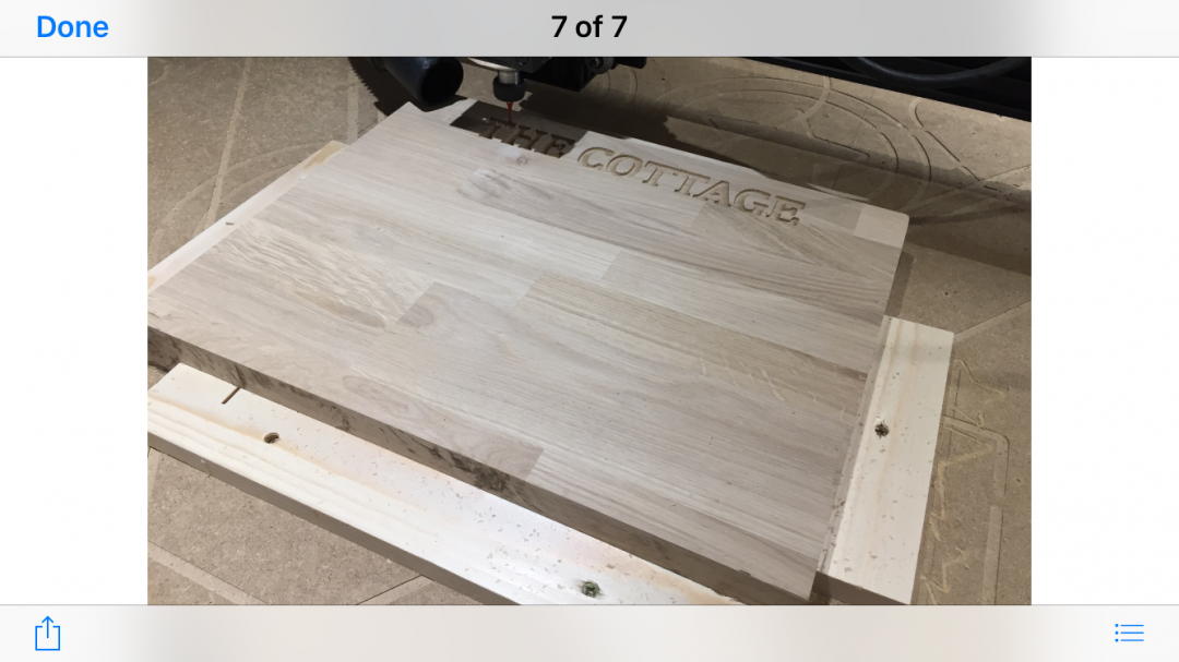

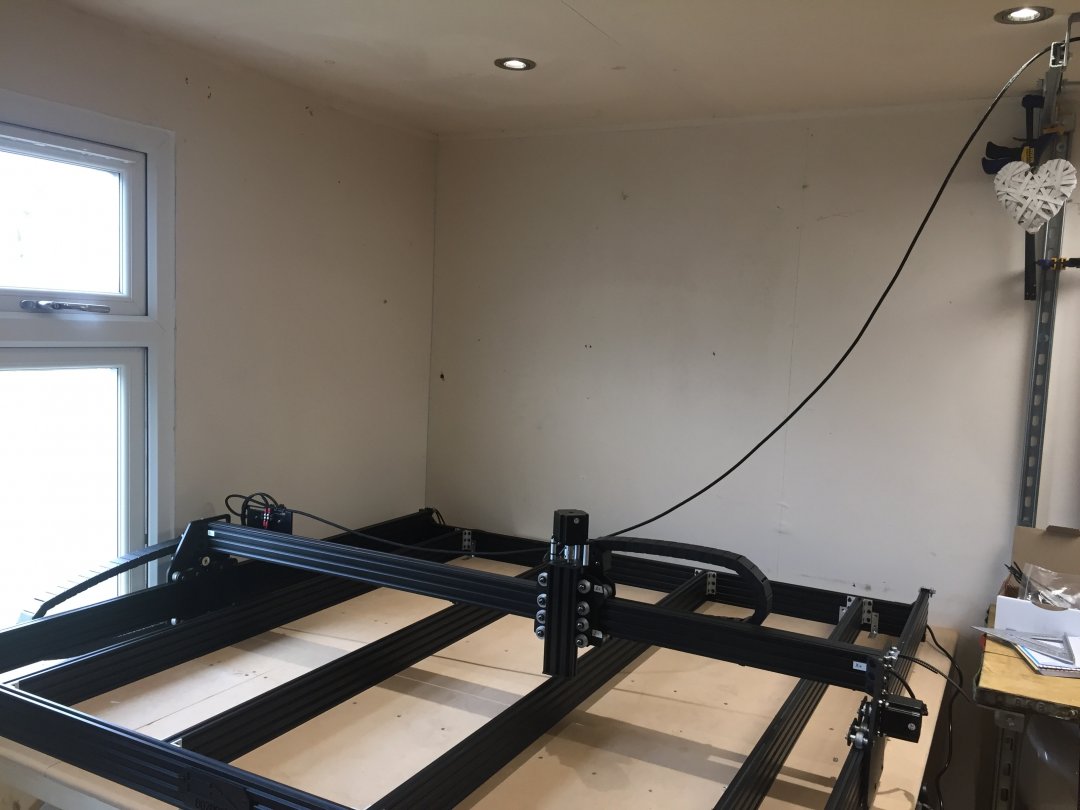

    I have no experience in making a machine like this so apologies if I have made any mistakes or school boy errors. I just like gadgets and making s#*t and this machine is bloody brilliant I'm well pleased
    1500mm by 1500mm

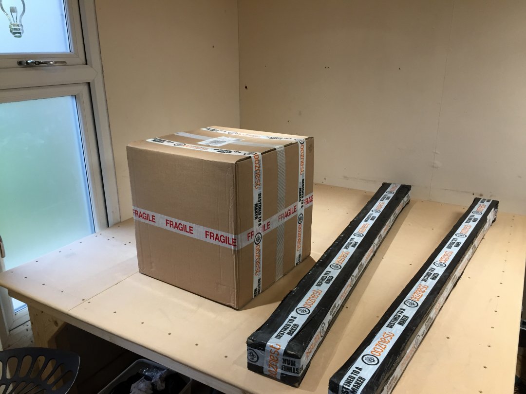

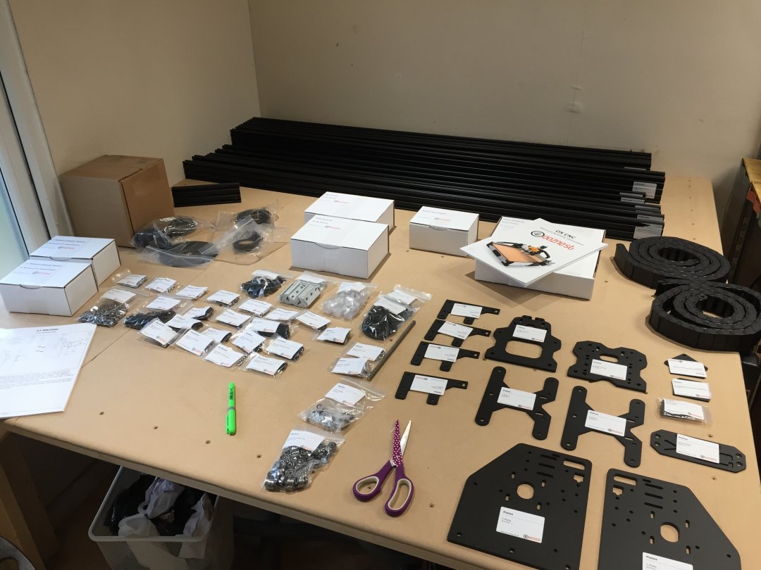

    Got this package last Friday! I do think who ever packed it has OCD issues even the tape with mm perfect. Two days grafting and I was cutting.
    Packaging 100%
    Instructions 98% only had two small issues mainly due to not reading the instruction. I did find the Y axis motor connection was running in reverse but was simple enough to fix.
    Parts 100% all look and feel quality.
    Build 100% would be easier if the eccentric nuts where at the top but I'm sure there is a reason for them being at the bottom.
    Commissioning info 100% entered all the data on the sheet and over a 900mm test (the length of my steel ruler) it was bang on it really was accurate.
    So far I have cut
    6mm MDF
    12mm MDF
    18mm MDF
    21mm OAK
    40mm OAK (engraved some letters
    I know I'm using the wrong router bits but I'm now skint so will have to wait a few weeks before getting so decent bits. Any recommendations for starter but would be appreciated.
    All the cuts to date are very accurate. 300mm circles are perfect mirror copies every time. You can see some tool makes but I guess this will improve with descent bits. The 21mm oak finish was the best finish and I did set this to 15 passes which was quite slow. Only trouble I do seem to have is the rebates some time filling with saw dust which seems to cause a poor finish on the thicker MDF. I'm hoping up cut but will reduce this.
    I'm not one for kissing *** or writing reviews but respect where respect is due. As Andy from the barley pickers would have said. Proper Job.
    Any chance of some free limit switches for the glowing review? And is it possible to add one of the fancy z axis calibration test link?
    Thanks Ryan and your team.

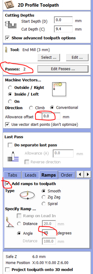

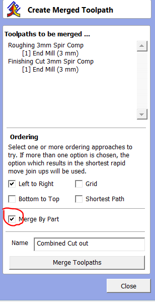

    Vetric Toolpath Strategy
    Gents (and Ladies)
    Does anyone have a good Strategy for milling multiple through cuts in MDF using Vetric.
    I have tried most options but it seems that either edge detail or precision is not brilliant.
    The best I have got so far is....
    3mm Spiral Compression cutter running at 24000rpm and 3600mm/min (Plunge same as it has a spiral ramp)
    If I add any leads they seem to be added outside the part I want to cut - not inside.
    Also I seem to get a witness as the tool withdraws and I cannot see how to take it off the cut face
    Does anyone have experience???

    @Matt-Sparks Thanks for the great write up and pictures, we love seeing them! I think i have given all our packers OCD, they are the ones now moaning at me for not packing things perfectly. An upcut bit should help with this and help bring the Debris to the top. Do you want to PM your order id, and i can sort something out for limit switches. Z axis calibration test link, is what Marcus posted you meant? You probably could make a home made one using a metal bar and two indicators.

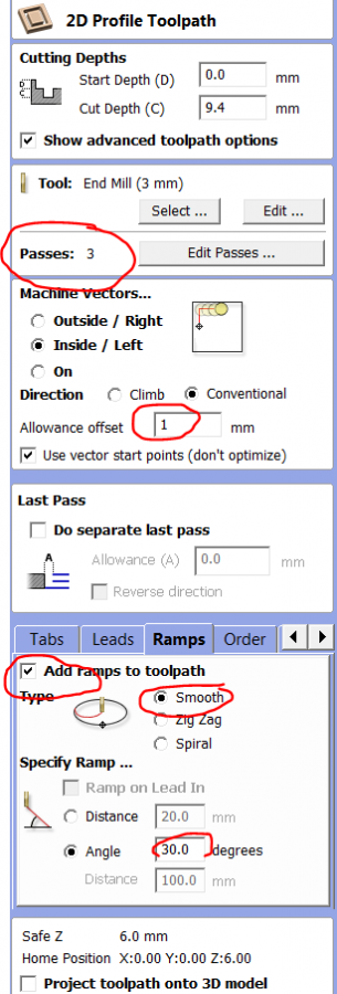

    @Marcus1 I would turn off separate last pass, i have found using this can give a poor edge finish as it cuts it full length. I tend to prefer leave an allowance, and take off the final bit using a separate tool path using multiple passes. I am unsure why it is adding ramps to the outside, if you send me the vectric file i can take a look.

    OK - I have followed your advice - First and second Cut Strategy....Merged
    upload_2017-5-5_11-24-42.png upload_2017-5-5_11-26-35.png upload_2017-5-5_11-28-59.png
    Preview.....
    Gives This G Code
    I will cut and send a photo

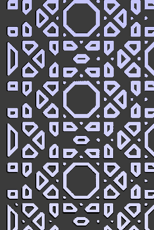

    Results - Ignore the black dots, this marks where the tool exited
    Red lines point to overcuts - I presume on the final finish pass as the tool plunges at 45deg ramp
    As tool retracts after finish - this is left. Presume I need to overcut, but without leads I cannot
    Issues everywhere!!!!!!
    Any advice? PLEASE :)

    @Marcus1 I can't understand why it is doing that, it should ramp within the profile. Could you send me the source Vectric file?

    Thanks for looking here is the vetric file
    Whoops - cannot upload that file type.
    Have renamed it dxf - when you get it rename to crv3d and it should be good

    I think this is more a function of the SW you use to interpret the G Code. I am using Mach3 and I do use the Z probing method supplied with the 2010 screen set.
    Marcus
  16. Marcus1
    Marcus1 New
    Jan 13, 2017
    65
    13
    Bingo
    Think I have found the issue.
    Mach 3 will run in Constant velocity or Exact mode (G61- G64 to cancel)
    Switching to exact the cuts are supurb (even though a little slower and jerkyer).
    Apparently CV mode smooths the transitions keeping up the speed of movement
    Hope that helps someone going through the same pain
    Marcus

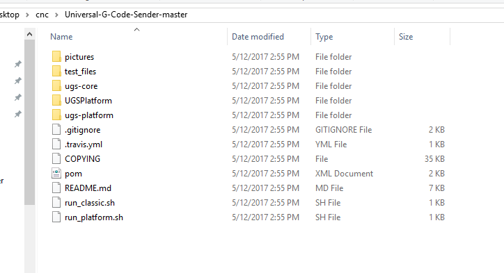

    I must be missing something obvious but i have downloaded and unzipped UGS, but i can not see the universalGcodesender.jar file.
    Can you tell me where it is
    thanks

    IMG_2585.JPG My one looks like this is thats any help.

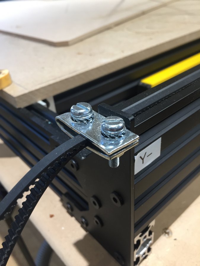

    Does anyone have a good handle on how tight the GT3 Belts should be. I have now had a few issues with (as it turns out) loose belt tension.
    Is there a guide on how to set it?
    Cheers
    Marcus

    Hi, i think this is because you have download the UGS Platform, there should be a second link which is UGS Classic GUI.
    Its a hard thing to say, but i have the machine screwed down to a table, and pull one end of the belt with pliers using all my weight (Average build). This gets it so it thuds when pinging to where it comes over the track to go to the pulley.

    IMG_2587.JPG Hello Marcus,
    I have doubled up the belts and it's working very well. I use a 40mm angle bracket and two 25mm m4 screws nuts and washers. I gave the belts a firm but not to hard tug while the wife nipped up the screw. It's a bit ruff and ready but working great

    I just tried that and the belt broke where the nip up screw had been:)
    Have ordered some more belt that I was going to double up - will have to order 2 more Metres

    Matt - I am intending to double belt - what advantages have you seen?
    Marcus
  29. Matt-Sparks
    Mar 29, 2017
    Morning Marcus
    I fitted double belts from the start so have no experience without the. I read some thread and watched some YouTube clips and it just sounded a good plan. I have the 1500mm by 1500mm and that seemed a long belt to me. Because both belt teeth sit nicely together the forces are transferred down both belts which reduces the stretch. It's only relying on the single belt as it comes up from the v wheels over the gear and back to the v wheel. All I can do is that my machine has been bang on from day 1. I had my first belt jump yesterday but the was due to a g code error the and router trying to push 8mm in one pass. A nicer clamping method would be to order some of the v channel blanking plates you would need 12 of them but it would look a lot nicer than my Heath Robinson job and the angle brackets.
    Hope this helps.
