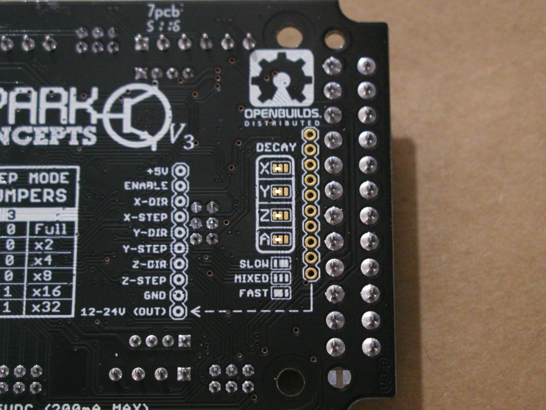

    I have been reading various and i see that its wise to add a fuse and a TVS between the OX power and the xpro v3
    Is that the same with the full kit (using provided 24v power), still needed? I have what I need, thought I'd ask.
    Also, re my question on fast decay, my v3 seems to have 2 columns with three pins. i cant work out from the piccie on the back which pins to jump still. If you have a picture of such, it would be amazing.

  23. MplsArtist
    Apr 11, 2015
    41
    Here's chance for me to give back to the forum.
    Rob:
    I needed to do the same thing for my machine to run better. At the local hobby shop I purchased a small, battery operated solder gun that came with some very thin solder wire. I added dab of solder between the first two contacts as indicated on the schematic for fast decay. After I did that, the machine runs beautifully. I've attached before and after photos with a mock up of where to put the solder. before.jpg after.jpg after.jpg
  24. Biglouie
    Biglouie New
    Apr 8, 2017
    Thanks man. Wow. So I solder the back of the board! I was thinking it was on the front side of the board and putting a little 2.5mm plastic jumper over the pins!
    I'll break out the solder iron. The picture. On the back makes more sense now too!
    Thx for helping me out.
    Rob
  25. MplsArtist
    Apr 11, 2015
    41
    You're welcome. Ryan Lock from OOZnest has been very helpful to me getting my 1500x1500 up and running. He told me about the fast decay soldering. Your solder dots don't need to be as small or neat as my photo retouching dots. Just don't let any solder touch the right most contacts.
