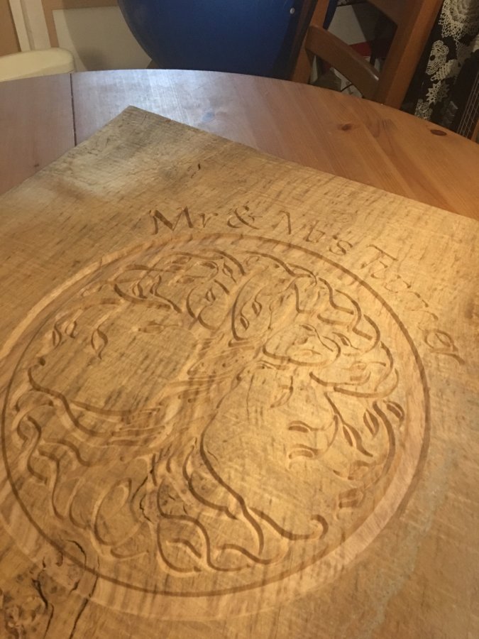

    So!
    My router bed has threaded inserts that are 6mm. I used 6mm bolts with bits of plywood to stop it moving.
    I didn't need to worry too much about it moving as it's a heavy piece and if you don't cut aggressively it won't move. That said I did make sure it could t move at all when coupled with the hold downs and the 6mm bolts.
    I also didn't do a rough cut I took it carefully. It's a nice piece of oak and you don't want to go too deep and tear away too much material.
    If you go too deep, two things can happen. You cut away your intended material but you also drag away extra material due to the fiberous nature of the material.
    It took about 6 and a half hours but I ran that at a conservative rate. It's a 3mm depth of cut (varies because I didn't face the timber ) and I took off about 1mm at a time. It's the only timber I had so I didn't want to mess it up!
    I used EstlCam which worked it all out for me although I had to do some manual editing and there was a bug in the software I had to work around.
    Feeds and speeds etc...
    It's oak so...
    90 degree chamfer v cutter
    2% step over
    20,000 rpm
    Feed 1427mm/min
    90% incline when plunging with the z axis and a z axis feed of 713mm/min.
    Where did I get this info? I got tired of the mystery of feeds and speeds so I just bought Gwizard for the year. It's so much easier!
    The finished piece looks like this.
