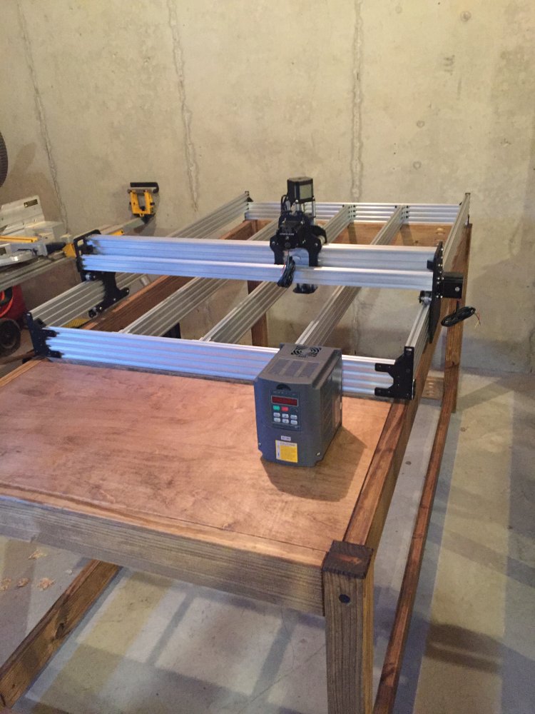

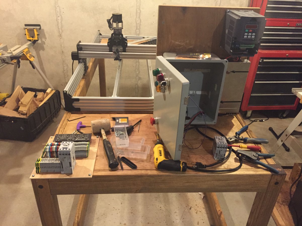

    I'm just getting my Ooznest OX build running. It's a 1000mmx1500mm version. This is my first CNC machine, and the Ooznest kit is perfect for that. I've got a background in electronics and industrial automation...but my mechanical skills are not as polished. So, the Ooznest kit, and instructions were exactly what I needed. I can't say enough of how clear, thorough, and complete the kit is. Great job on that Ryan!
    Having the kit parts so thoroughly organized and labeled was such a luxury. The kit went together flawlessly, and was very enjoyable to build. IMG_6770.JPG

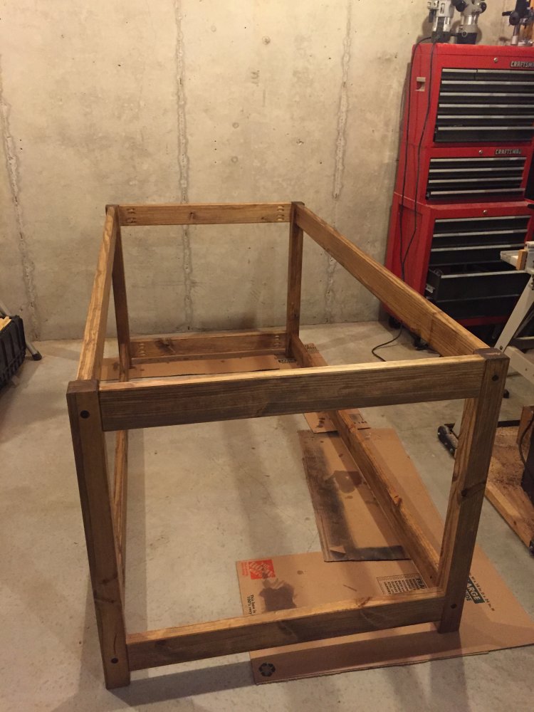

    After mechanical assembly was done and I took measurements of the final machine size, I built up a wooden table made with breakdown bed-bolts so it can be moved. Where the machine sits, only the frame was built...that is there's no table top under the machine. This is so I can mount stock vertically since I plan to machine parts for woodworking. IMG_7003.JPG

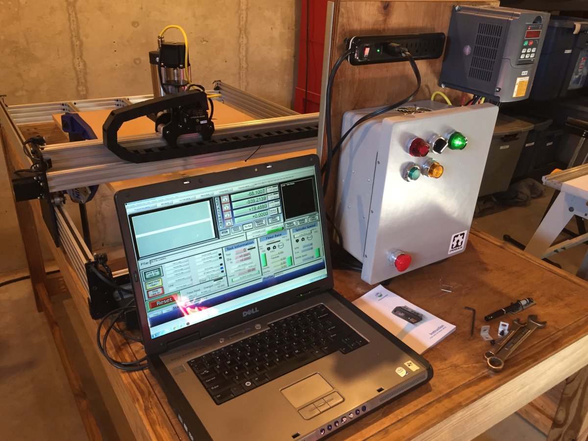

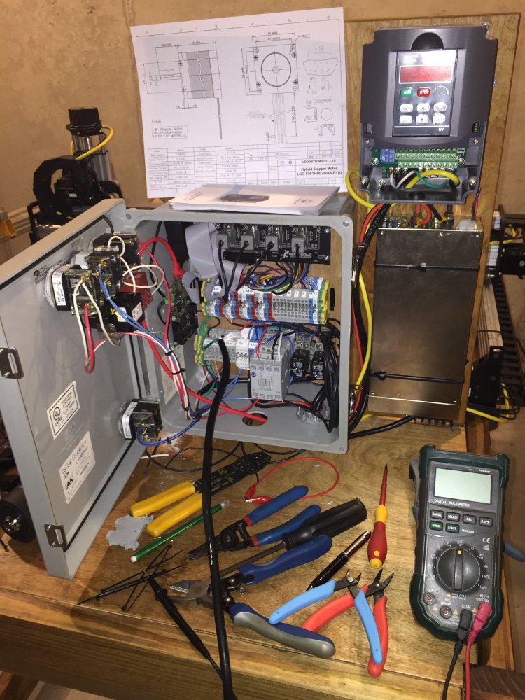

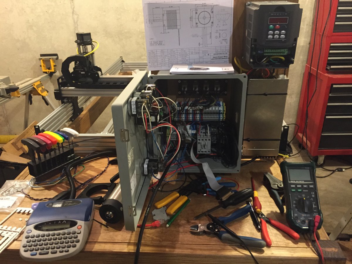

    For the controls, I went with Mach3 software (my brother gave me his copy he no longer uses), Gecko G540 driver, and the Warp 9 Ethernet Smootstepper (ESS.) The ESS allows me to run everything on a crappy old dual core laptop running Windows 7. There's no missed steps or data underuns (well as long as you disable the screen saver and low power modes!)
    I built up a control cabinet using a leftover enclosure, parts, relays, switches, terminal blocks, etc., I had on hand. Unfortunately, my box is a bit too small and everything is quite tight inside. I really needed a box twice the size, with Panduit to hold the wiring. IMG_7082.JPG
    I had a 20amp Meanwell 24volt PSU on hand and used that as a PSU. I'm in the US, so the entire machine runs off a single 220v feed (since the VFD requires 220v). One leg of that provides my main 110v power, and a switch on the front turns on the master control relay (MCR) and 24v supply /control power. A contactor tied to the MCR switches on the 220V source to the VFD. Lights indicate that 220v is present (red), 24v MCR is on (green), and VFD is enabled (yellow). I have a relay for enabling the VFD...but also use a separate input for the Estop circuit. IMG_7283.JPG
    Strangely, the way the Gecko G540 is setup...the EStop is not wired to drop out the MCR as you would normally do in a control scheme. Rather, it's treated more like a safety system input...where Estop is just another input and the controller is responsible for dropping power. I didn't like this at first...but it turns out it provides some benefits (like maintaining torque and position on the motors while Mach3 goes into software Estop....handy for tool changes!) But the G540 responds correctly to the hardwire estop button and drops all power to the motors.

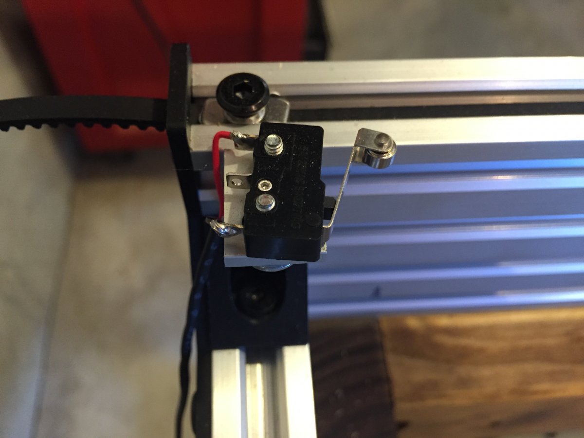

    A single hardware Estop button is on the front panel of the cabinet, and two limit switches are present on each axis (8 in total.) I initially only planned on a single set for the Y axis...but later learned that Mach3 can use a separate set for each motor on the Y axis when homing. That is, with switches on each side, it will ensure both switches are made during homing in order to reset any racking that has occurred due to missed steps, manual tampering, etc.
    I used microlimit switches, but really need a better way of terminating the wire. I soldered them, but that left the 24v connections unprotected. I threw some electrical tape on them for the time being...but I really need some decent plugs or termination solution. Still looking for that. IMG_7286.JPG

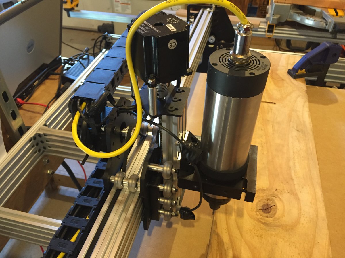

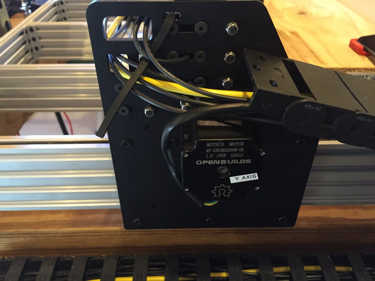

    I bought some e-chain / drag chain off Amazon for the wire management. That works surprisingly well. For wiring the limit switches I've temporarily ran the wires under the machine. Next time I disassemble the machine..I'm going to drill wire holes in the corner endplates so that the wiring for the Y axis switches can be run through the inside of the V-rail. I do this for the x-axis switches and it works great; so clean.
    I got a 1.5kw ER11 Air-cooled Chinese Spindle/VFD combo from eBay. (seller nice-shop2 who was very helpful and had great communication for a Chinese seller.) I took a cue from Ryan's build and ordered the OpenBuilds spindle mount and some mounting brackets. It was until later that I noticed Ooznest had a kit for this. I'd recommend going with the kit. My spindle is 65mm, and the OpenBuilds mount is for 75mm. So (again following Ryan's lead here) I went into Sketchup, designed a simple spacer, and had it 3D printed at Shapeways. IMG_7289.JPG
    For wiring, I bought some multiconductor cables off eBay. 4 and 2 conductor 20awg. 20awg is pushing it as far as ampacity rating for the motors. But, the wire isn't heating up, so I'm happy.

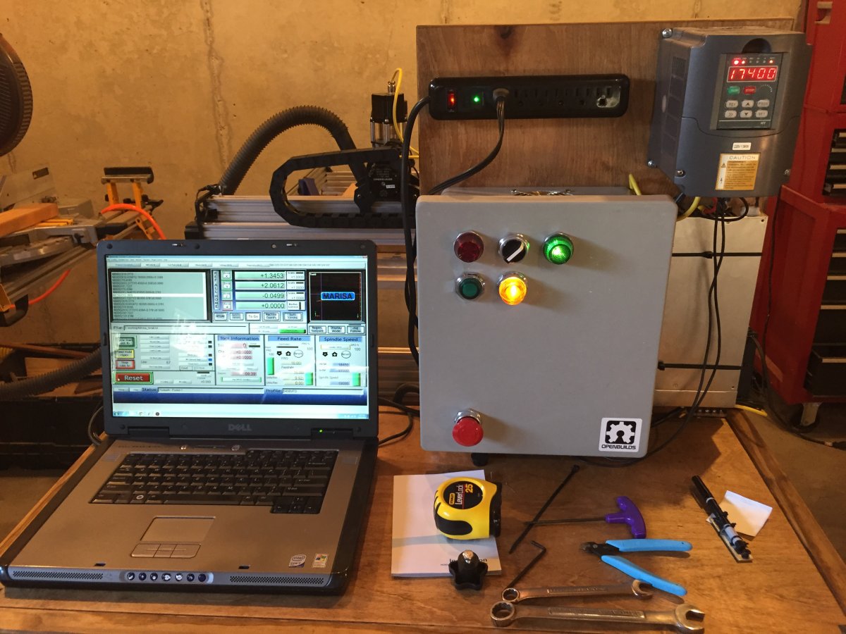

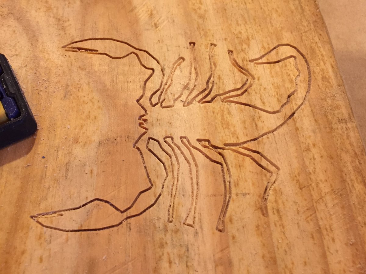

    I've just down a few test cuts and projects now. I'm using Vectric software for my CAM, and generating vectors in Sketchup and Multisim/Ultiboard (for PCBS). IMG_7288.JPG
    Just getting a few test cuts done: The Mach3 demo scorpion...and a quick sign out of some old cedar fence board: IMG_7299.JPG

    I think you're a top contender for the prettiest control cab. I wish you were my neighbor!
    Great work Dave. That stand isn't to shabby either.

    Wow Dave, your electronics setup is truly impressive. A beast of a spindle you have got there, do you know how heavy it is? it will be interesting to see how the machine performs with that on it.
    Glad you like the kit and a huge thank you for the kind words.

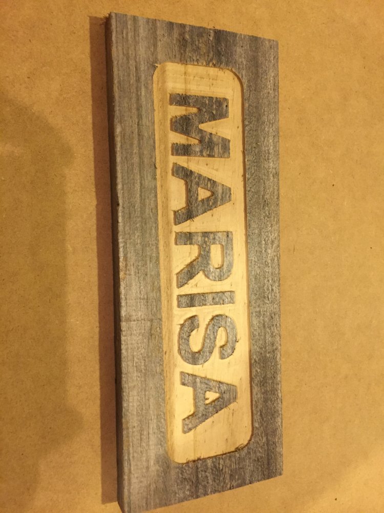

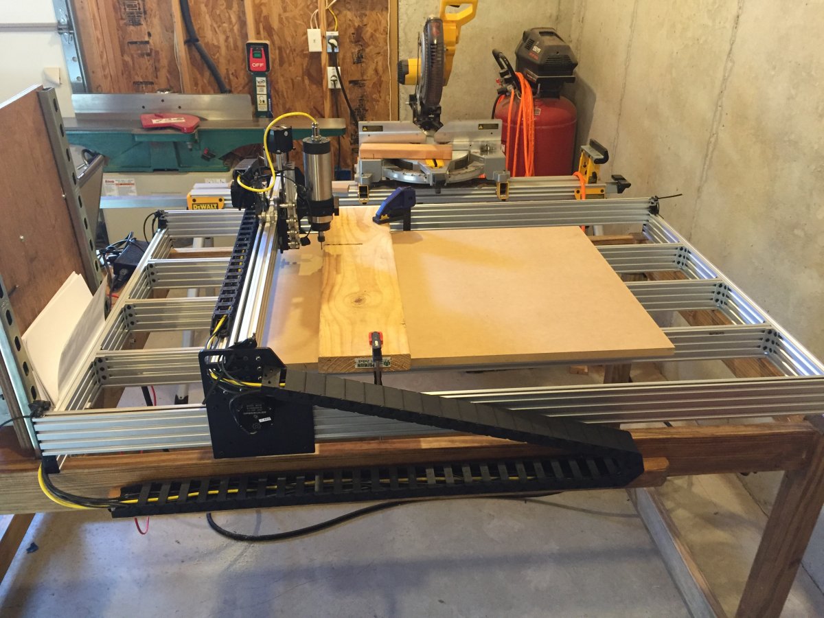

    Getting things fine tuned now and starting to produce some usable goods: side panel replacements for some Moog synthesizers.
    I need to work out a better clamping setup. Still thinking of cutting T slots in the spoiler board.

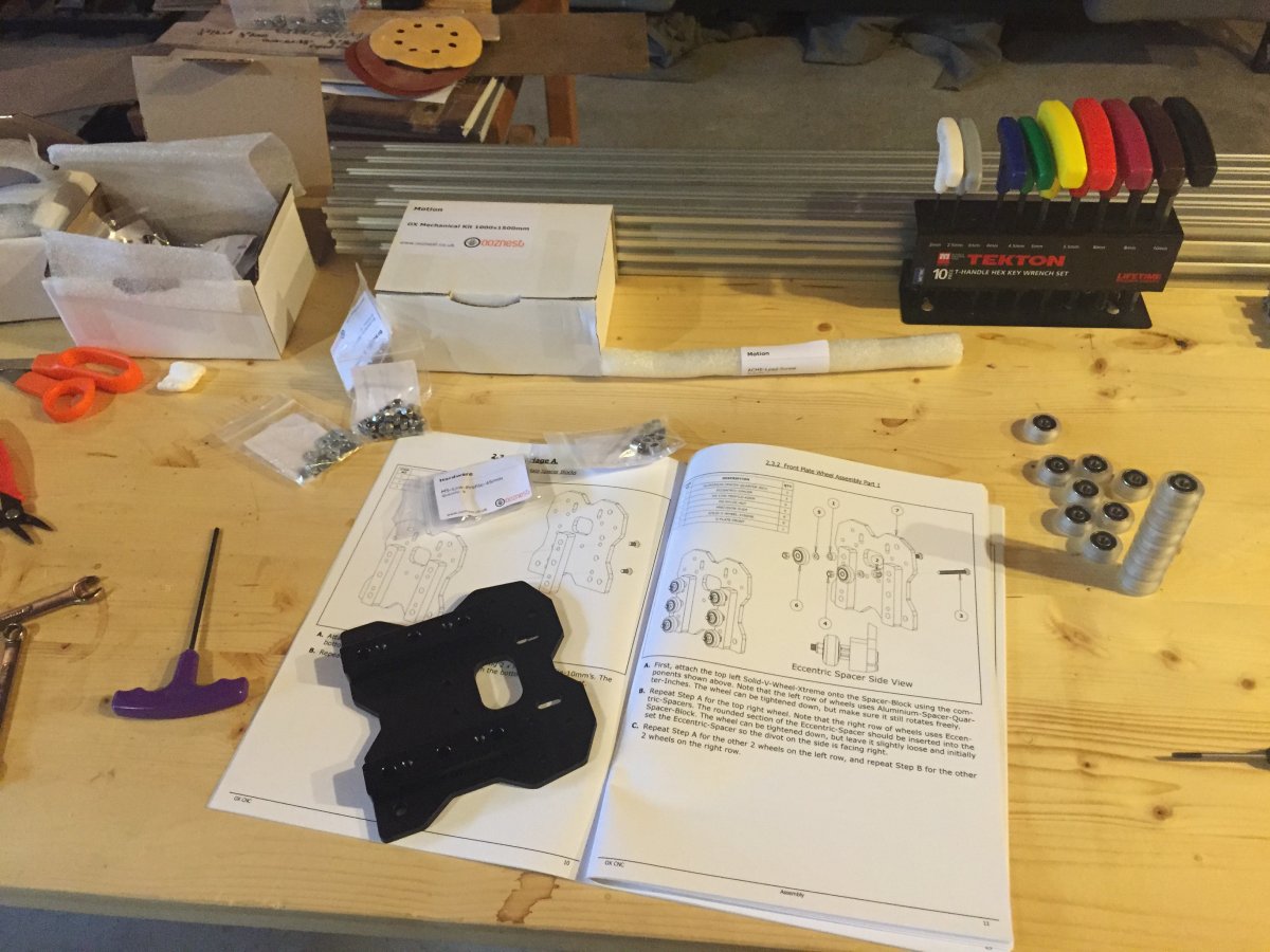

    Here is an example of the kit and how well the contents are packaged and labelled.
    You might also like to see my technique for putting all those wheels in place. The build manual suggests doing such stacks one at a time, but I found that to be tricky to get the stack in after the first.
    So I taped the head of the bolt to the back of the plate and then laid it down on some wooden blocks and built all at the same time, being very careful to get the spacers, shims etc in the right order. The two photos should make it clear
