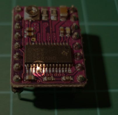

  7. OldDogSleeping
    Oct 22, 2015
    Hi,
    I got my ooznest up and running yesterday :);
    Still quite a bit to do but getting there.
    I've started out with a budget control system: Grbl with a CNC Shield and DRV8825 drivers.
    If you look closely you'll see I've modified the driver modules;
    This is to put them into Fast Decay Mode. Before I made this mod, I found the motor's worked well at speed, but not very smoothly at lower speeds ( say 100mm/min ), and micro-stepping was erratic at best. After a fair bit of research and some careful testing I found that the modules were not managing to make the microstep increases in current, but instead jumping from 0 to full current in one step. Changing the drivers to Fast Decay Mode, fixed this, and with the micro-stepping working correctly I found that 1/32 micro-stepping now provided smoother motion, where as before the mod it made no difference.
    One thing I'm confused by is why so many people have their Grbl settings so slow. I've set my X and Y axis max rate at; 18000 mm/min, and accel at 600 mm/s and it seems easily able to cope with these speeds even at 1/32 micro-stepping and the current limited to 1.5A on the drivers.
    I'm really pleased with how well it's moving now, next job is to make a bench, and then wire it up properly.
    Kevin
    #157 OldDogSleeping, Nov 20, 2015

    @OldDogSleeping Great to see another machine built. From conversations from customers who have tried 1/32 micro stepping, it caused accuracy issues when cutting, such as circles not aligning. And when they went down to 1/8 everything worked fine. It will be interesting to see how you get on.

    I managed to spend another half an hour with my build today. Other stuff getting in the way, so slow going.
    I have it still in temporary wiring mode, but a little temporary shelf on the back of the gantry is stopping stuff from flopping around.
    I have run up against what seems to be a common problem of the motors sounding like woodpeckers. I am powering from a 550w 12 v ATX power supply and have taken GRBL settings for the xPro from SergeE's thread on this problem. No GRBL settings seemed to change anything. I have the xPro power outputs set to about 50%. Varying those made no difference either.
    However, the breakthrough came this morning when I took the advice, again from SergeE, to add heatsinks. I had a couple of power transistor heatsinks, which I cut down to about the right size and just temporarily stuck them on top with some thermal paste. The xPro is currently horizontal so they sat there quite happily. Lo and behold the motors run sweetly, at least for about 50mm at 3m/min feed rate, even up to 4m/min. Further than this and they start pecking again. The xPro is currently in the open air, so no fan, but if I blow on it while performing the move, it just runs nicely.
    What is obviously happening is that there is a rapid sequence of thermal cut out and reset going on, and this causes the pecking and loss of loads of steps.
    It seems to me that heatsinks and a fan are essential for an xPro to work at all. It isn't true to say "you only have to simply wire up your machine to get it working!". So why aren't heatsinks of the right size/shape included, or at least some guidance that this is necessary? Anyway, I shall be on the hunt for a more permanent solution. Any pointers would be welcome.
    And finally, would it be better to trade up to a 24V power supply?

    Yeah, the datasheet for the DRV8825 specifies cooling when driven at 2.5a. Not sure why xpro didn't include. Most of the pololu type step sticks come with heat sinks. I used some copper VGA heat sinks, and that solved the issue. I've run mine at 12v and 24v. Runs fine with 12v, maybe a little more speed with 24v. I kept the 12v in place, because I have an emergency stop wired for the ATX power supply, and I'm too lazy to change it.
