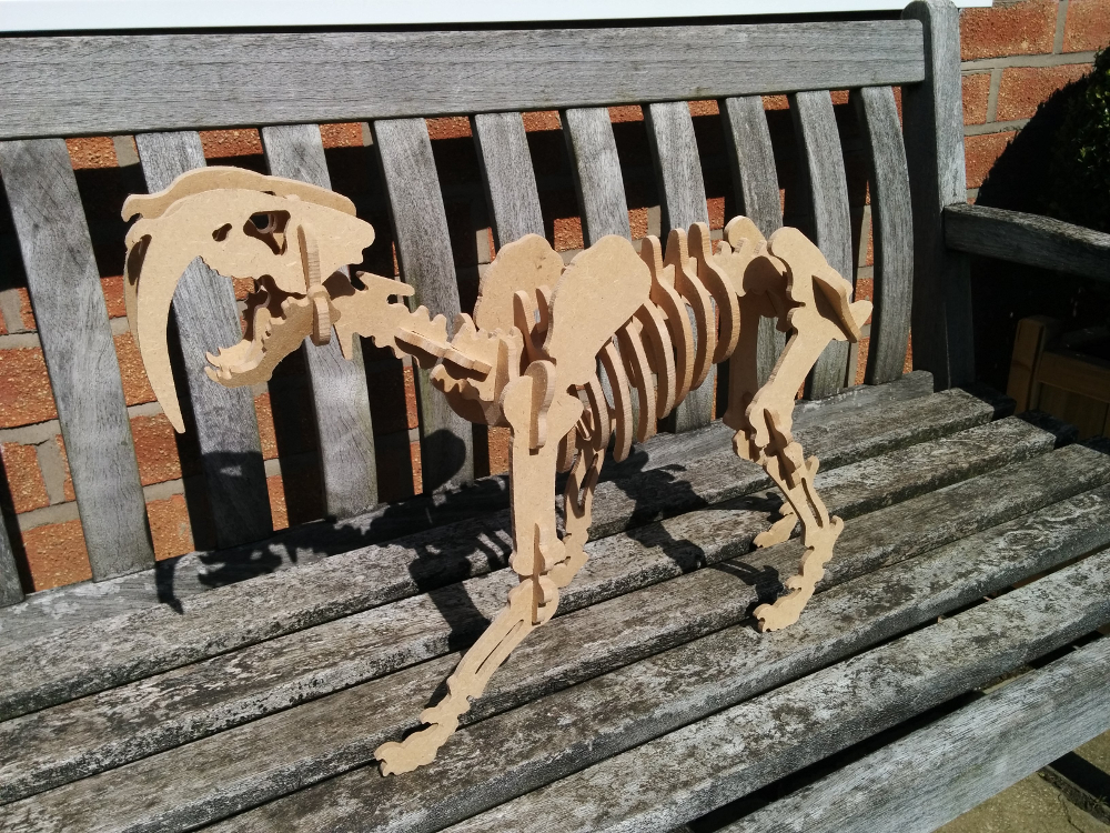

    I haven't been around for a while. Have been busy with a few other things. But I thought that you would like to see my latest creation. I expect it will be one of a series for the grandchildren.
    Also, just a reminder for those concerned about the Z-Height - it can be modified, as it my previous post (it's on page 7 of this thread) IMG_20160423_115937.jpg

    Amazing!!!! I'm building the cnc, and i hope soon i can make project like that! what bit do you use? have got the file project?

    I used a 3mm twin flute bit. Cutting speed 1000 mm/min, and 2.5mm per pass. The material is 6mm MDF, and it really is only a test piece, I have a dust shoe attachment that I made so there is virtually no mess in the cutting process.
    I think that the finished articles are more likely to be in 5.5mm ply, or perhaps even 3mm for smaller models. Haven' tried that yet.
    Now, the "file" is a bit tricky. I have spent quite a bit of time fighting with various bits of software and files downloaded from the internet. I am a retired software engineer, so I HATE fighting with software that doesn't do what I want. So I have started to write my own!!! It does exactly what I want, but unfortunately it is not really ready for release to others. So the GCode for this beast was generated by my software. The original source was a freely available DXF file from somewhere out there - I forget precisely where. There are loads around.
    However, in this particular case the DXF is really bad, consisting of thousands of very short straight lines and they are not even joined up. My software - with a bit of encouragement from me, will join up the lines, smooth them out to circular arcs or bezier curves and do various other transformations associated with the slots which have to match the material thickness, which of course varies! It will then generate the toolpaths necessary to give the final shape according the the specified bit size. And there is the issue of how many pieces will fit in the machine area. This particular fellow took three sheets of 300x400 mm , which is a comfortable size for my small machine.
    Below is a shot of one of the cutting sheets as portrayed by my software. The black is the required shape, the green is the slots, and the red is the toolpath. It is ordered so that slots and any inner shapes cut first.
    So I can't really provide a "file" yet, as it is all inside my code.

    @mel earp Wow nice piece you have made there!
    Regarding the segments in the file, can you export the dxf as a black and white JPG? because the software Vetric sell have a function which will trace blacks lines from a picture into smooth curves.

    I do understand that there are lots of packages out there which could do the job. BUT, I am a retired software engineer and I actually enjoy writing the stuff. It's the challenge of learning and overcoming problems that makes me tick. If I end up doing things the long way round then that's just part of the enjoyment. I can usually write some code to do a job more quickly than I can get into a different package.
    And in answer to Paruk's comment "Why not say that you don't want to share it?". This is simply not true. I don't have anything that would be worthwhile sharing, because my code is not readily shareable. It might be in the future but right now it isn't. Please don't accuse me of something that isn't true.
    I know that models like this are readily available. There is a thread on CNCZone which has hundreds of them. The original Sabre Tooth probably came from there.

    I managed to find the original DXF files and accompanying pdf that this was based on.
    My model is modified a little because a couple of the slots are the wrong way round in terms of the direction of gravity. They would be fine if the target was a permanent construction, glued perhaps, but not if the intention is for a childs 3D jigsaw where assembly and disassembly is the norm.

    I prefer this one in terms of stability and fun for the grandchildren. I had to modify it quite a lot because of the gravity problem again. I have also attached the original DXF. It is called BRONTO1, and didn't have any assembly instructions in it or accompanying it. However, after some research, it isn't a brontosaurus at all. It's a triceratops. A skeleton photo from Wikipedia helped a lot in the assembly.
    The jaw line probably needs modifying too - to show the third horn above the mouth parts.
