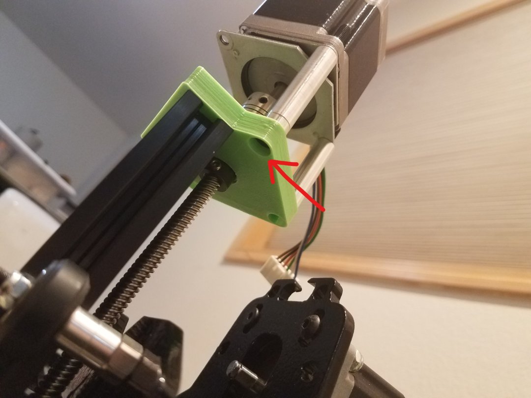

    I wish i could give you a full review, but the prints i received didn't work out and snapped while I was adjusting the wheels. The issue was definitely with the printer though so not really your problem. Overall I was very happy with the thickness and had these not snapped i definitely would have kept them. I loved the idea of having the recessed mounting holes because you would be able to print covers to hide the hardware (not to mention having nice bulky appearance). My home printer has a limited build volume so i was only able to reprint the Z axis bits. Both pieces were printed at 75% fill with .2 layer height. One change i made to both top and bottom was the addition of a 2mm lip to stop the lead screw bearing from sliding through the mount. The other was a change for the Z motor screw holes where they seemed to be facing the wrong direction (see photo for the change). Ill give you a heads up if i find a way to try out the other pieces from a different printer.

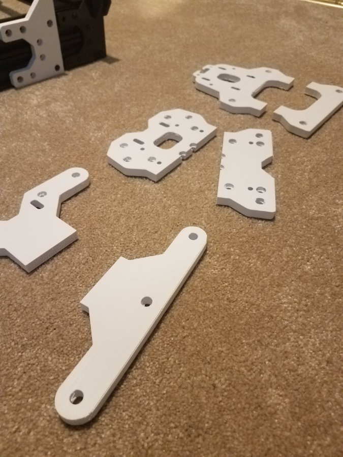

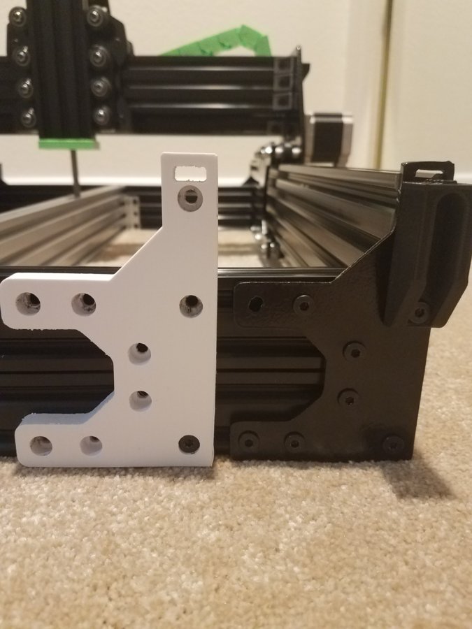

    Thanks for your response mate. Interesting that the parts snapped. Did you print the parts yourself and did you print in PLA or ABS/PETG? If you got them printed via 3D hubs, it may be that the printer didn't actually print at 75% infill - happens quite a lot with 3D hubs unfortunately and it's difficult to determine exactly what infill they used. I'll have a look at the Z axis part and see what went wrong and fix, thanks again for the heads up :)

    Im starting to think it was printed in PLA and the infill does look a bit light. what did you use for your drag chains? Ive been printing up "Drag Chains HD" from thingiverse, but they seem a bit narrow.

    I haven't printed and assembled mine yet unfortunately - just don't have the time and so many other projects going at the moment. If you did get these printed from a printer service, it may well be the case that they didn't print with enough infill. You can check if it's PLA or ABS by using various chemicals on the plastic - google for more info :)

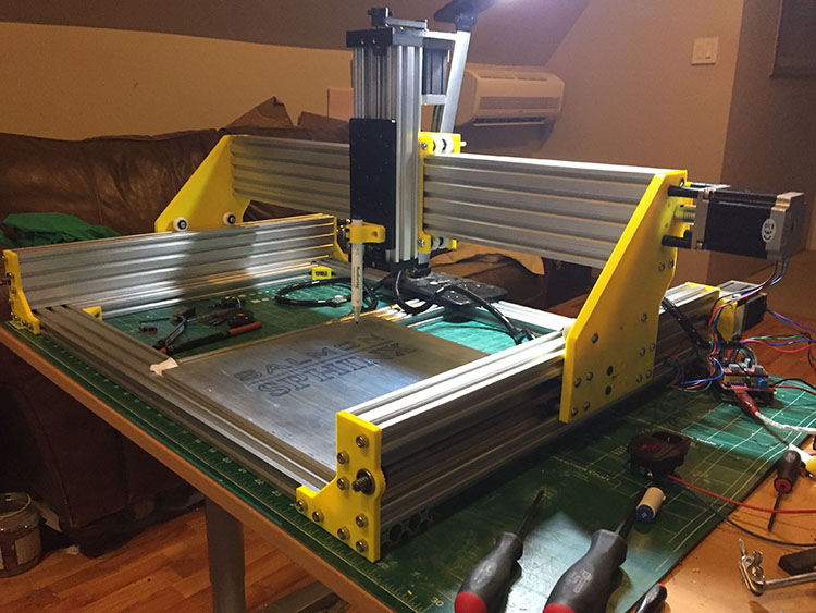

    EA, you shouldn't need any reinforcement. I 3d printed all my plates for a Sphinx and was able to slowly cut new ones out of aluminum. I did mine at 50% infill, 8-10mm thick, and used ABS. I even had some pretty severe head crashes and they never broke. You do have to go very slow and take shallow cuts for aluminum. The plastic will flex, the endmill will chatter and if you go too fast, will evntually bite and break. I had a lot of breakage, but was new to CNC, so I suspect some of this was just normal learning curve.

    Another option is 3D print a plate to use as a drill guide with a drill press that is squared up. Use the printed part to trace onto aluminum. Cut close to the line on the aluminum plate with a table saw or chop saw. Definitely wear eye protection. Clamp the aluminum plate to the printed plate and drill 4 of the holes that are spaced far apart. Using your 5mm screws and nuts securely screw the printed and aluminum plates together. With the plate sitting on four screw heads, it should be level. Finish drilling your holes. Then, use a flush cut router bit in your router. Trim away the excess aluminum so the two plates are flush--easiest with a router table. Repeat as necessary. Done! You now have aluminum plates with no need to disassemble the machine at a later date. Also, you will probably be done a lot quicker because the 3d printing part takes the longest by far. I wish I had a 3D printer at the time of my build, it would have made my plate cutting by hand a lot easier using this technique.
