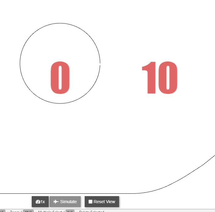

    Hello, any help why the vector are open? I created the dxf file from Solidworks. Thx

    Try to save it as a R14 polyline DXF if solidworks provides that option.

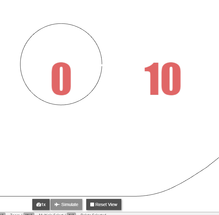

    This is my setup but the result is the same...This toolpath contains 1 open vector(s), and 0 closed vector(s) :-(

    OpenBuilds CAM needs closed vectors for any offset operation (inside, outside, fill and pocket). Give it clean proper files and alls well.
    Open vectors can't be offset by Clipper (geometry library)

    Hi Peter, yes I agree but I don´t know what is wrong with my drawing. Enclosed you can find the origin file. I´m not able to create in Solidworks the right dxf file.
