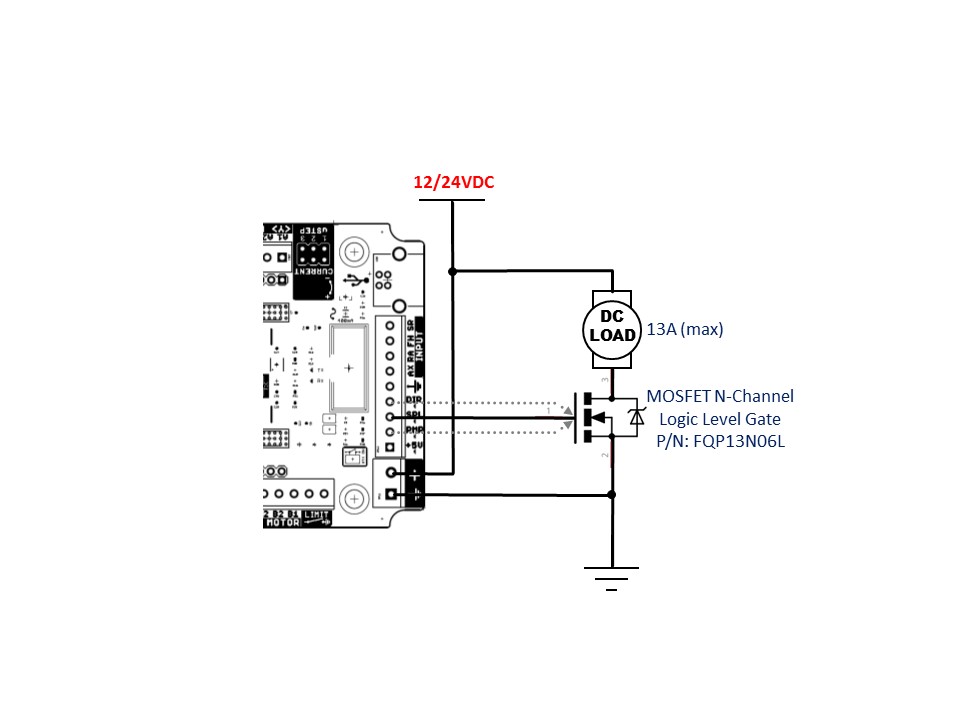

    Hello, I've assembled my ACRO and it is awesome, I have the laser powered up with a power supply and my PWM PIN attached to the cancelled shield. I have not been able to get grbl to turn on the laser. I've used the commands to turn the laser on m3, just to try. I have been looking at all the wiring diagrams but I think im missing something.
    Does anyone run a 3.5w 3 wire chinese diode that can help me hook this up properly? I am using an Arduino uno with a v3 cnc shield in laser mode. And help would be appreciated.

    Buy this https://www.amazon.com/gp/product/B00CHTLAIS/ref=oh_aui_detailpage_o06_s00?ie=UTF8&psc=1 then ill help how to wire it up that is your missing link

    your power supply is the same for the machine and the module?

    It can be... I have both available.

    both are 12v or 24 for the machine and 12 for the module
