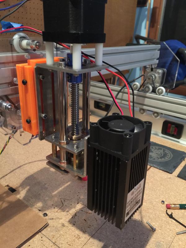

  20. WildBill
    WildBill Well-Known
    Feb 4, 2017
    52
    40
    While I like the idea of having an adjustable Z-axis I am not sure that the 2040 beam can take the torque, and I am sure I would not put a router on it.
    I actually ordered a "SMALL light weight" Z-axis unit today to try out that I think will work well because I have one on another laser system that is not as well designed as the ACRO. I will attach a picture with the one on the other system.
    It is more than enough for a laser but is not heavy enough to take much more.
