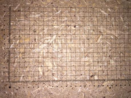

  6. WildBill
    WildBill Well-Known
    Feb 4, 2017
    52
    40
    I took the existing leg design and extended them some and laser cut them.
    In the picture you can see the original leg next to the new longer one. I also
    made a small tray with corner holders which keep any wobble out of the legs.
    The little dowel on the rail is my focus gauge. I move the Z until it just fits between
    what is going to be etched and the bottom of the laser.
    The second picture shows a raster image of the target I use to calibrate my gray scale, it was a little hot at this point.
    Mark Carew and Ariel Yahni like this.

  9. WildBill
    WildBill Well-Known
    Feb 4, 2017
    52
    40
    The best way to describe it is a waste board with the L in the corner's so the laser frame won't move or twist. The 2020 frames are quite light and and there is not much surface area on the bottom of the legs so its real easy to knock and move it. This takes that risk away. I also etch alignment marks in the waste board to align things. There is no intent for it to change the height.
    This is where all the height adjustment is done. With the Z axis all the way down it will focus on the surface of the waste board, and go up from there.

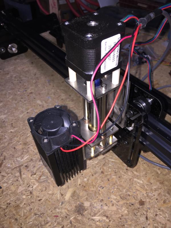

  12. Deleted member 20791
    Guest Builder
    I loaned my 50x50 XCarve to my frienf François, who cut the alu parts for the Acro system and we assembled it today. Now just need to hookup the laser. see here Log In or Sign Up to View

  14. Able224
    Able224 New
    Nov 3, 2017
    That z-axis looks very promising! Where can I buy such a system? Thank you!
  15. Peter Van Der Walt
    Builder Resident Builder
    15,699
    4,510
    modular parts bolted together from openbuildspartstore.com (;
    (Read above, his Z axis was removed from a complete machine, so probably not available for purchase as-is. Therefore, i'm sliding in a little cheeky marketing. It is a fact though, little piece of v-slot, mini-v carriage, nema17 plate, should be easy to rig up your own...
