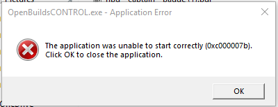

    upgraded to 1.0.172, and it will not launch. I get the message below.
    I reverted back to my last download, 1.0.156 and it works fine.
    Windows 10.

    :) wrong thread. This is OpenBuilds CAM
    Control is over on: OpenBuilds CONTROL Software
    Hehe
    156 is pretty old so hard to know what the issue is then. Head over to OpenBuilds/OpenBuilds-CONTROL and try a not so old version like 170, or 169.
    Also, uninstall and cleanup before installing the new version. Try a different PC too.

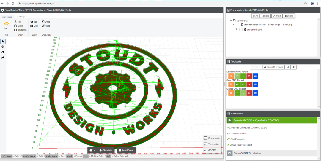

    My lead is now powered up finally, but I have been having issues with the OB Cam software. When I add a toolpath, specifically a pocket, I will click on "Apply" once I have my settings complete and then it gets stuck in "Calculating Toolpath" and I have to close the whole window down and lose my project. I am using Chrome as my web browser. Any ideas what is causing this? Anybody else have this issue?

    4,511
    Please post your file (dxf or svg) and screenshot of your pocket settings
    here is my jpg
  23. Peter Van Der Walt
    Builder Resident Builder
    15,699
    4,511
    Make sure you export as DXF R14 Polyline format :)

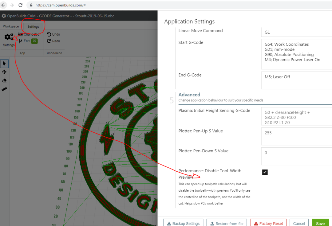

    OK so took your file, and ran a Lettering, Gear and Circles ops, same settings as yours, no problems :)
    Attached OBC file (Can be imported from CAM -> File -> Import OBC) to see what I did.
    I am not sure of your PC specs, but if its a entry level/oldie it might just be running out of steam. Try disabling the Tool-Width-Preview from Settings
    and at the bottom here, the attached OBC (Workspace export)

    Awesome thanks. I was trying to do an inverse of what you did, which would leave the lettering, gear and circles raised and everything else recessed. When I selected to make a pocket out of the "ring" with the lettering inside of it, I would select the larger circle that borders that pocket and use that to create a pocket. Should I have selected something else? I am doing this on my work computer so it has plenty of juice, it is what I run solidworks on. I will try it also on my personal desktop as well.
    As for the DXF R14 polyline format, it actually made it worse doing that. Could be because I sketched over a photo in solidworks using splines and it just isnt converting well? In the dxf preview when I converted to dxf it looked good, but went crazy when I import it into OB CAM. I attached the OBC file and the dxf for that.

    But moral of the story is that i dont think its bug, per-se. The bigger problem here is workflow: I would never expect to do such a massive pocket with a 1/8inch bit! So its creating unneccesarily large toolpaths. Sure you can do that in Fusion360 or Vectric but on the free solutions one sometimes has to compromise on expectations. In this job I would probably do my pocket with say a 8mm or 10mm bit, then run the letters as Outside cuts with the 1/8th to cleanup their details
