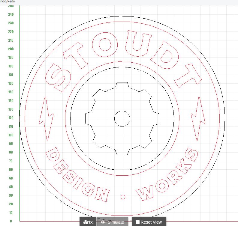

    So quick question. In that file I sent you, how would I select just that area where the lettering is to be pocket milled to leave the lettering raised? When I click on the outer circle of that lettering pocket it automatically selects everything inside of that. Is there a way to select just that pocket that the letters are in? As far as I can tell it only lets me select just the lines.

    Only lines yes, so thats kinda where Cad comes in, you can draw in helper constraints if needed

    Thats unfortunate, so it will automatically select any and everything to the inside of that line?
    Builder Resident Builder
    15,699
    4,511
    No no. It select whatever line you select. It doesnt autoselect anything else (except when you are in the MOVE tool)
    Whatever is "red" forms part of the toolpath, so lets simplify the explanation.
    Take the letter A. It consists of the outside shape, and triangle in the middle. Select BOTH, create a Pocket. it will now intelligently know to NOT pocket in the triangle, and draw a proper A. But if you just select the outline, it will happily chow away the triangle too. It only does what you tell it

    Trying to guess what you wanted to make:
    If I select just this:
    (using the first circle out, and first cicle in as constraints for the pocket, the next line in will be the letters, thus subtracted from the geometry, and the next line in from that would be the inside bits of letters like O, D, etc which will in turn be added to the geometry and thus milled (odd/even polyfill standard: Javascript Clipper / Wiki / documentation)

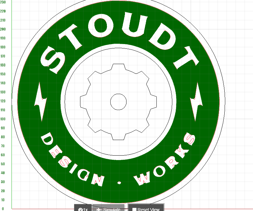

    the resulting pocket op is this:
    That will mill away the green bits so letters will be proud of the bottom of the pocket

    okay got it! Didnt realize I had to select each letter too...but that makes sense. Definitely appreciate all the help!
