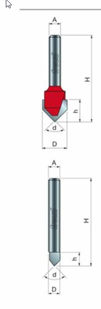

    Still learning here... got a question regarding toolpaths in CAM. What do you specify for the Endmill diameter for a V bit or angled engraving bit? Or does it really matter? Do you just pick a no-offset vector, and ignore diameter and just work with the cut depths?
  12. Gary Caruso
    May 19, 2016
    1,204
    536
    Typically the dia is the max dia of the V-bit, not very important unless doing deep carves.
    example from Freud, the capital "D"
    Cheers
    Gary
  13. romamaker
    romamaker Well-Known
    Nov 14, 2017
    69
    56
    Ah, that makes sense. I had seen in some of the other CAM software I've looked at that you can specify pretty much the entire geometry of the tool / bit. I just wasn't sure what to do in the Openbuilds CAM, since you just specified the diameter. But it does make sense to specify the maximum diameter it could cut. Thanks!
  14. Peter Van Der Walt
    Builder Resident Builder
    15,699
    4,511
    In OpenBuilds CAM, v-bit arent properly supported (doesnt do the correct maths that say Vectric would do to finish sharp corners, etc) , so its entirely up to you. If you just want to engrave a v-shape groove "on the line" then the no-offset operation will do. Endmill diameter just "moves" the toolpath away from the CAD line by half the endmill diameter (offset) so in an ordinary cut the final product is correctly sizes (machine moved tool half the endmill away from the cut, endmill removed the material, what's left is where the line was)

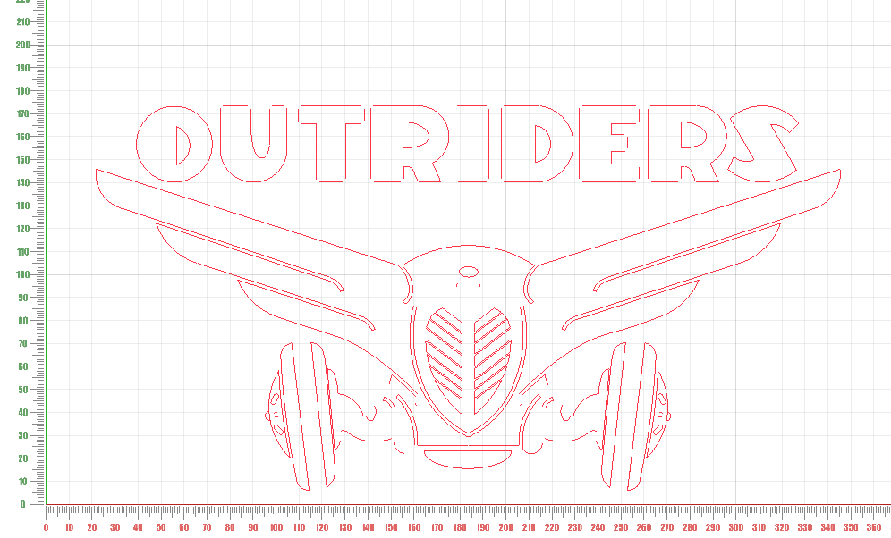

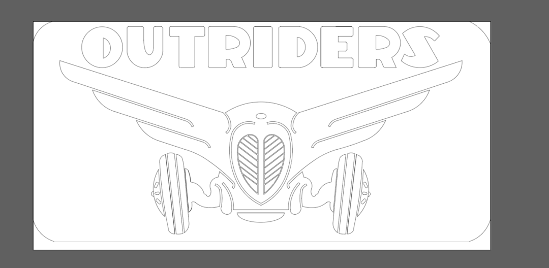

  20. Rich Ricket
    May 28, 2020
    Guys, Newbie here - I've got great hopes for CAM, it's exactly what I'm looking for. However, my dxf file seems to be misinterpreted - looks fine in all other software but CAM seems to corrupt some arcs per the attached graphic - anyone got any ideas?
  21. Peter Van Der Walt
    15,699
    4,511
    You need to export (save-as) your DXF as "R14 Polyline" format
    Alex Chambers likes this.
  22. Rich Ricket
    May 28, 2020
    Thanks Peter - that's the options I used - version R14, with "export all splines as polylines" selected. I've saved annotation views, selected various faces, enabled and disabled merging, upside down views etc...the DXF always looks right in every other reader...Assistance appreciated - I'm stumped. I really want to get this to work :)
  23. Rich Ricket
    May 28, 2020
    I tried converting the lines in the sketch to polylines, and the dxf looked ok in eDrawings, but loads into CAM looking like it was drawn by a 3-year old with big gaps :)
  24. Rich Ricket
    May 28, 2020
    Peter - I've edited the dxf files using Notepad - the problem seems to occur when an arc is going from (eg) 270 degrees to 0.0 degrees, or if it passes through 0 degrees, it flips to the opposite direction (the dxf AcDbArc lines don't include any direction statements).
  25. Peter Van Der Walt
    15,699
    4,511
    I tend to just throw non working DXFs into QCAD, save-as R14 Polyline.

  27. Rich Ricket
    May 28, 2020
    Peter, you're a star - thanks for bearing with me - QCad conversion worked a treat
