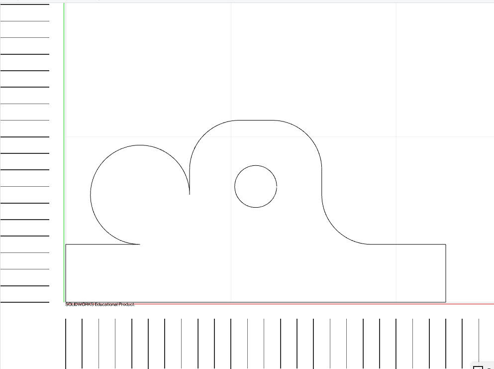

  13. Dan Biskup Home
    Oct 12, 2019
    Use Shopbots at school, Use VCarve... Unfortunately cannot get the shopbot VCarve version to write the GCode file.
    so Im trying to learn how to use this for my new Lead 1515.. Love the configuration.... Trying to import a DXF. saved from Solidworks in several different formats....
    including the polyline version of R14 and R13 and R12... still not right.
    This is what I always get. Take a guess what its doing. Was able to move the origin without problems... but that radius on the Left.... you guessed it should be an internal radius.
  14. Peter Van Der Walt
    Builder Resident Builder
    15,699
    4,511
    Post the DXF so we can tell you whats wrong with it. But basically, see docs:software:file-errors [OpenBuilds Documentation]
    Also, see Vectric Post: docs:software:vectric [OpenBuilds Documentation]
  15. Dan Biskup Home
    Oct 12, 2019
    Late last night I found that my version of vcarve would read the dxf and allow me to join the vectors then re-save it as a DXF... When I did that I was able to read it in to Openbuilds CAM to define the tool paths .... Haven't cut parts yet but I ran a simulation.... And it's looking like it should work...
    Also working on trying to add the Openbuilds Post processors to my edition of vcarve we'll see what I get.

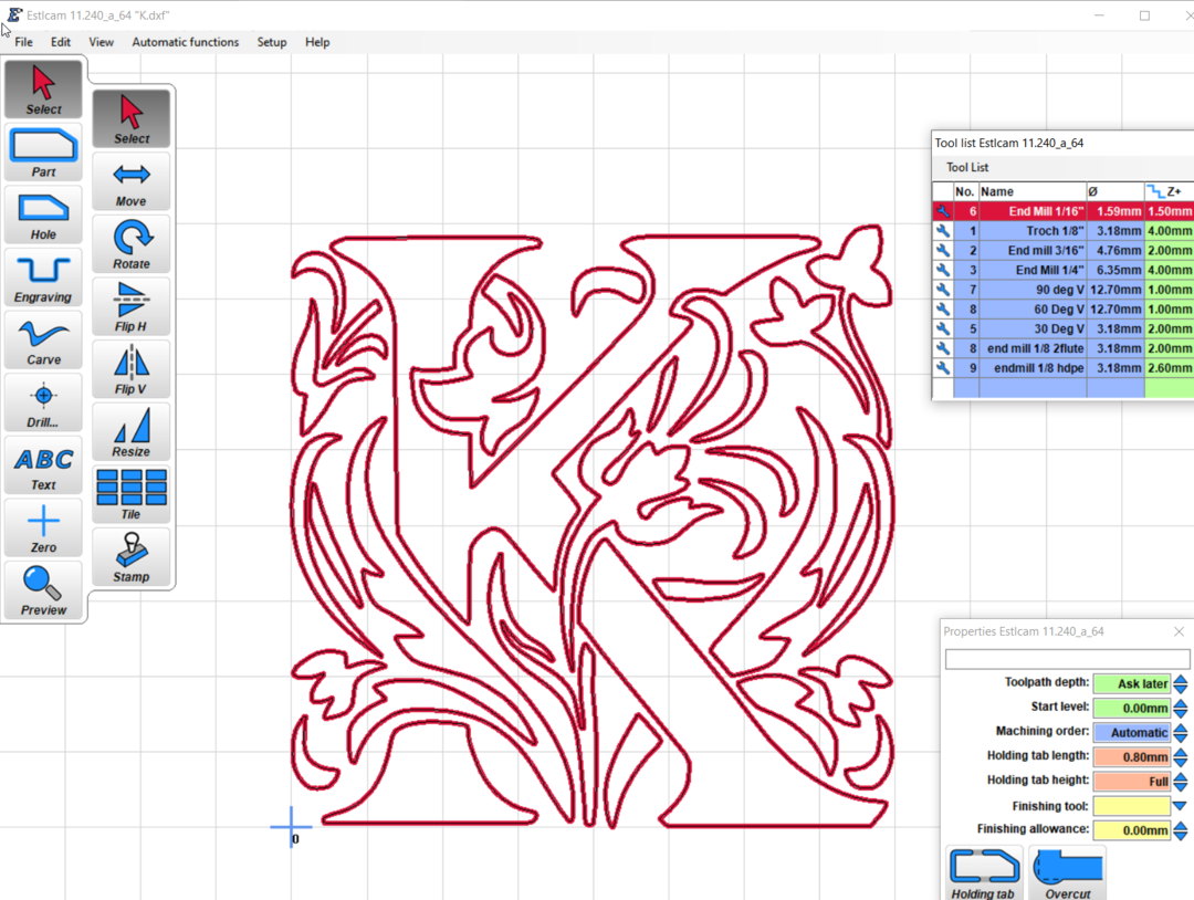

  25. Sophabean
    Sophabean New
    Aug 1, 2016
    Thank you for your response I have attached the file that I am working with. What do you mean by convert it to polylines? I am fairly new at this so please be patient.
    • K.dxf
      File size:
      1.8 MB
      Views:
      170
  26. Gary Caruso
    May 19, 2016
    1,204
    536
    Opened the file in nanoCAD and it looked like it was made out of blocks (and many many objects), opened it in inkscape and it crashed.. opened in Estlcam and had no problems.
    Cheers
    Gary
  27. Giarc
    3,062
    1,718
    Estlcam works well for me too. Like Gary, it opened up for me and I had no issue creating tool paths. Estlcam was well worth the $59 license (You can try it for free for as long as you like) and tool path generation is very similar to Openbuilds CAM.
    As for the "k" file, I hoped to have a solution for you as I started writing this and taking the screen shots. In the end it failed so I opened it in Fusion360 and it looked "odd." Only two of the entities appear to be "closed" (shaded blue indicates this).
  28. Sophabean
    Sophabean New
    Aug 1, 2016
    Thanks for looking at it, I got it off of Etsy. My wife saw it and challenged me to justify my cnc machine lol. Would I be better off just attempting to create it myself at this point?
  29. Gary Caruso
    May 19, 2016
    1,204
    536
    What are you trying to do, simple engrave or v-carve? you could download free Estlcam and try it or ask somebody to clean up the file, was it an svg or jpg first?
    Cheers
    Gary
  30. Sophabean
    Sophabean New
    Aug 1, 2016
    It came with a DXF, PNG, PDF, and SVG. She would like that K raised with a 3/8" border on an 8X8 piece of hardwood. Essentially all of the negative space needs to be one large pocket. I started with the DXF file because it is the only way that I know how to do it, and that doesn't seem to be working out for me. I downloaded Estlcam and will give it a shot. Thank you for your help.
