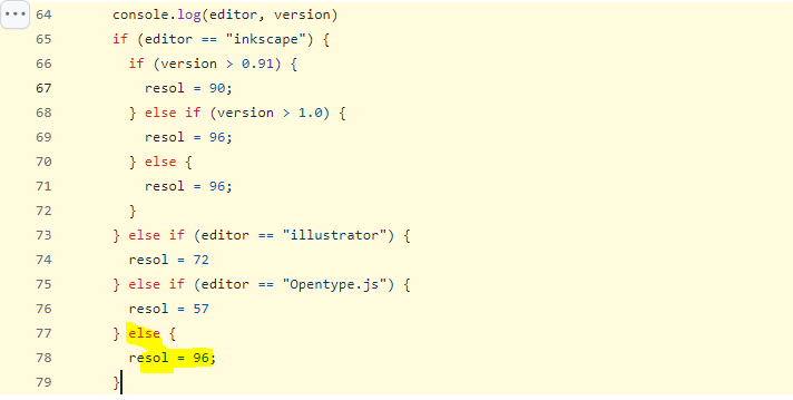

  5. Peter Van Der Walt
    Builder Resident Builder
    15,700
    4,502
    Well you'd first have to answer my question
  6. dwelch
    dwelch New
    Apr 12, 2024
    16
    Problem has nothing whatsoever to do with inkscape, but anyway, version 1.3.2
  7. Peter Van Der Walt
    15,700
    4,502
    It actually does. Wouldn't ask if it doesn't. If you clicked the code reference provided, you might notice the parser heavily relies on that information to make a decision on the DPI to assume the file is exported as
    Did you click?
    If so you'll notice the code uses the Inkscape Tag and version to determine the default DPI (As inscape changed between 90 and 96 dpi over the years)
    SVG is pretty much unitless. The internal unit is px. px * dpi = real world measurement - so scaling issues always relate to DPI
    SVG doesn't have a standardised way to communicate what the DPI is so we have to guess based on presence of flags like the editor or editor version.
    So if I open Inkscape and draw a 100x100 px square
    Just do a File > Save
    then it has the expected metadata in the header

    to obtain a Editor type (Inkscape) and version (never use it so installed version here is far behind, on 1.0.1)
    Anyway
    Loading that into CAM the code can do its thing to parse out the metadata, see what version it is, and then scale it accordingly
    Giving you a perfect 100x100mm Square in CAM
  8. Peter Van Der Walt
    15,700
    4,502
    Your SVGs seem to have no metadata to satisfy the editor field, so its handled as
    Code:
    File: forum-thread-144159-file1.svg was created in 'unknown' version 'NaN'  Setting import resolution to 96dpi
    There is an unassigned internal enhancement request for "enter the DPI you used" popup for the unidentifyable cases, maybe we can push that a little toward the top, but just exporting with the Metadata (or without metadata but as 96 DPI) will get you sorted for now (As you mention using Inkscape v1x, the default would have been 96dpi even if the metadata is removed)
    #8 Peter Van Der Walt, Apr 13, 2024

    Okay I see that why would it default to a 96 pixels per inch default when it sees points as the units rather than a default dots (points) per inch of 72? The file says points not pixels. And now if you go into the file and say mm not dots not pixels, etc. so there are no dots per inch it is just mm. then it still has an issue, does it convert from mm to dots at 72 per inch then turn around and convert dots/points to pixels at 96?

    So I guess the bottom line is that OpenBuilds CAM needs inkscape
    format svg files not just svg files?
    And the answer appears to be yes, you cannot just import svg files they have to be inkscape marked?

    } else if (editor == "illustrator") {
    resol = 72

    Not specifically, but if in doubt just use 96dpi (Pending the future update where we can maybe ask you what DPI its at.) for the export from anything else (so it strikes that last "else" condition).
    It reads SVG from anywhere. No worries about that. But moving between applications, knowing we expect 96pdi (standard) would help ensure whatever you export it from, exports as 96dpi. Inkscape used to be the outlier (90dpi) for a while but least they also caught up and switched to 96dpi in v1.x, so its rare to still find input files that aren't 96dpi.
    Review OpenBuilds-CAM/js/svgparser.js at d39bc9a66c044668e3df4b1ddd79c7640184fc95 · OpenBuilds/OpenBuilds-CAM alongside OpenBuilds-CAM/lib/lw.svg-parser at d39bc9a66c044668e3df4b1ddd79c7640184fc95 · OpenBuilds/OpenBuilds-CAM to see what it does, and no its not perfect, but as its an open source project - if you want to help improve it you are always welcome :)
    The bane of graphics apps everywhere. SVGs units are a minefield. CAD guys got it sorted, DXF carries the Units - much easier.
    Some history Units In Inkscape - Inkscape Wiki
    And yeah some other CAMs have it more tuned in, but you are about the first person having issue with this in a long time - most others have more standard workflows of saving SVGs from modern graphics design suites that usually uses the 96dpi standard. Unless they manually change DPI on export, it is just usually 96dpi and works.
    96dpi x 93.75% = 90dpi
    So exported as 90 dpi?, should just export the SVG as 96dpi.
    We'd only try 90dpi if the metadata says its inkscape 0.92 or newer, but older than 1.0 - newer (and more widely used on other applications, international CSS standard, etc) were all 96dpi.
    As it doesn't have metadata that matches, you end up where we guess it should be 96dpi, but its exported at 90dpi, thus the size difference.

    So this is interesting...cloned the repo. (can open a javascript terminal to see the output, duh, first time for me messing with javascript).
    console.log(editor, version)
    resol = 72;
    console.log("File: " + name + " was created in " + editor + " version " + version + ". Setting import resolution to " + resol + "dpi")
    scale = 25.4 / resol
    sure scale = 1 / resol / 25.4 is the same, maybe a weee weee bit of rounding error. that didnt change anything but left that line in there...
    31.75 mm from 72x72 point square path.
    resol = 96;
    23.8125 mm
    so this 23.8125 is from a 96 dpi/ppi. as you indicated. but makes no sense
    72 points / (96 points / inch) = 0.75 inches * (points/points) = 0.75 inches * 25.4 mm/inch = 19.05 mm not 23.8125
    72 / 72 = 1.0 inches. = 25.4 mm not 31.75
    scale = 25.4 / 72 = 0.352777778
    0.352777778 * x = 31.75
    x = 90
    scale = 25.4 / 96 = 0.264583333
    0.264583333 * x = 23.8125
    x = 90
    There is a common factor in there.
    and the units are
    scale = (mm/inch) / (points/inch) = (mm/inch) * (inch/point) = mm/point
    mm / (mm/point) = points
    x = 90 points,
    I am missing some unit.
    So it is not strictly the resol = 96 vs 72 there is some other factor somewhere affecting this.
