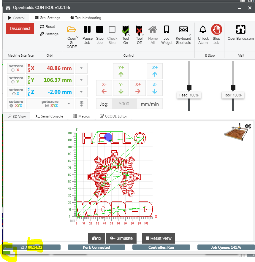

  3. Shqipetari
    Nov 14, 2018
    13
    Yup, I'm aware of it. Kinda hard to square time vs "quarter of the way through " or qeue of 130097 to go.
    Just a thought. If it's a pain in the neck no worries . Beggars can't be choosers.

    Oh and also in v1.0.156:
    Keyboard Jogging/Shortcuts
    And [BETA] of Continuous Jogging (@David the swarfer I think you were waiting for this)

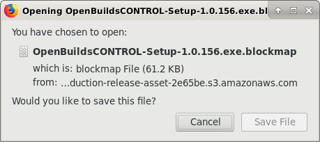

    Been trying to get it but the link to the linux .deb gives me
    and there is no .deb on github

    Will check Travis build tomorrow!

    OpenBuilds/SW-Machine-Drivers now has a .deb build too
    [edit]v1.0.157 is out though (has deb too)[/edit]

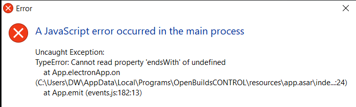

    I installed the control software on my fairly new laptop and it gave me an error upon opening. i was wondering if the program will open even if it isn't connected to the controller? Fyi, here is the error message I'm getting when i try to open the program. Also, i prior to installing / running i updated my laptop as well as "java".
  27. Peter Van Der Walt
    Builder Resident Builder
    15,700
    4,510
    Will check today when i get to work.
    For now, grab older version from github.com/OpenBuilds/SW-Machine-Drivers/releases

    Thanks. FYI, 1.0.158 installed and opened.
    Have a great week!
  29. Peter Van Der Walt
    15,700
    4,510
    Fixed in v1.0.162: OpenBuilds/SW-Machine-Drivers
    You can update from within control (It will prompt you next time you run it, check the Serial Log tab) or manually from the link above :)
  30. Michael Laley
