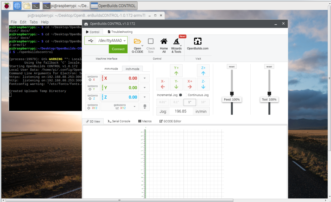

    Any reason this shouldn’t compile on a Raspberry Pi 3 Model B? I’ve followed the steps precicesly here: OpenBuilds/OpenBuilds-CONTROL
    I do get some unverified package warnings which I force install using the --allow-unauthorized flag.
    Also, npm doesn’t seem to be getting installed in the nodejs step. I’ve verified that nodejs 8.x gets installed, but npm doesn’t.
    Using the latest Raspbian Stretch with Desktop image:
    Download Raspbian for Raspberry Pi
    Let me know if I can include any logs to help.

    RPI is not officially supported, therefore this nice warning at the top of the Wiki:
    "Instructions below are provided as-is and expects the user to be fluent in Linux, Electron, NodeJS and Git commands. No support or assistance will be provided, this instructions is for those who want to venture where there is no support. You are on your own! :) Have fun!"
    The steps worked for me when I tried, thats all I can vouch for. Google some of the errors, work the problem :) speak to your Linux geek in the basement (;
