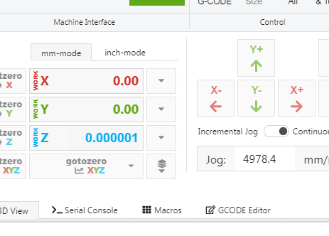

    You can click on the numbers in the DRO
    Then type a new GOTO value in (so note its absolute, not relative. If you are on say -10, and want to go down by 0.05mm, type in -10.05[enter]). Or hit setzero first, then type a number (; no maths needed hehe

    OK. I learned something. It's not as handy as a custom incremental jog that can be repeated in any axis direction, but I see how it can be done by setting zero each time and inputting the same +/- value over and over again.
