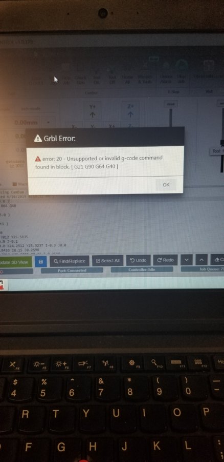

  10. Los215
    Los215 New
    Jun 10, 2019
  11. Peter Van Der Walt
    Builder Resident Builder
    15,699
    4,510
    Means your Cambam setup is not using a Grbl compatible Post Processor. Grbl only understands a subset of the Gcode, probably doesnt like G64 and G40.
    G21=millimeter mode
    G90 = absolute coordinates
    Check Cambam docs/forum for Grbl Post Processor info
  12. Award
    Award Well-Known
    Nov 12, 2018
    60
    35
    Grbl doesn't support the G64 command so it is having a sulk!
    Here's the list of what it does support: gnea/grbl
    Cheers
    Adam
    My apologies Peter got in there first!
