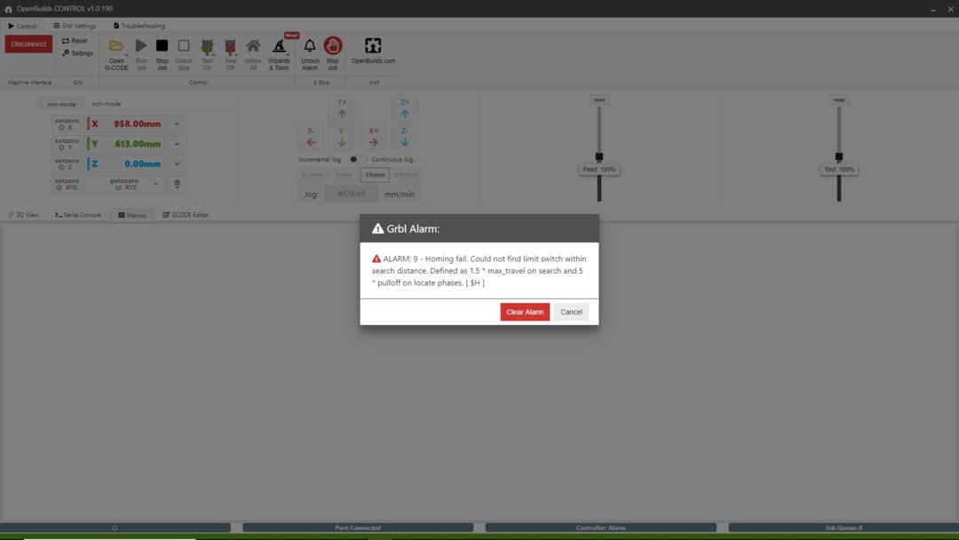

    OK Here comes my dumb post of the month.
    just started recently, ( last few weeks ) after a cut I hit the home switch and machine takes off as per normal, and then 3/4 s the way to home I get an error.
    was unable to get pic, screen froze. Alarm 9 homing fail. could not find limit switch within search distance. defined as 1.5* max travel on search and 5* pull off on locate phases [$H]
    Why does these feel like a setting was changed (Not Me, No Way. it was working fine )
    I checked my home switches, they check out ok. Also, when I hit home 2nd time it resumes and homes ok. More of a nuisance than a real problem.
    Any suggestions appreciated. Thanks Steve

    The error is telling you that it cant find the switches. It also says that it will only go 1.5* your max travel to find them. It does this so it wont run forever. So what you need to look at is your max travel settings. Go into the settings tab and scroll down settings $130 and $131. Are those set correctly?
    If not, that's 1 - the reason for the error and 2 - you were probably closer to the switches when you homed before and thats why they worked.
    If that's not the problem, report back and we'll do some further digging.

  12. Steveathome
    Steveathome Well-Known
    Oct 7, 2017
    68
    28
    Thanks, that got it.
    for some reason values were $130 = 290 mm and $131 = 290 mm
    changed to 839 and 335 respectively and worked great.
    how would these change, I haven't been in these setting since setup. Cause I had to look around to figure out how to save the changes.
    Is it possible the last update brought them in?

    Nope. They were probably never set correctly in the first place.

    Maybe at some point you loaded a profile? The 290 and 290 seems like some sort of default setting, but the grbl default is 200 and 200.
    @Peter Van Der Walt can confirm this or not, but updating control doesnt touch grbl. The values you see in settings are what grbl is telling control they are. As an example (and I'm not saying this happened) if you were to connect to the BB using a different interface and change a grbl setting then reconnect with Control, you will see that changed setting. Control doesnt keep those settings on your computer, so updating control doesnt change settings.
    Really what I'm trying to say is I have no idea :ROFL: But I'm glad you are sorted.

    100% confirmed. The ONLY thing that can change settings is a user, and it needs at least two clicks (click once to select a profile, then click save) or two clicks and some keyboard action (scroll to input, click in it, type, click save), or click in serial console, type a $x=? Command and press enter. NOTHING else touches the settings. And never will.
