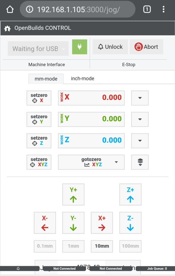

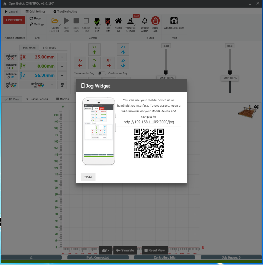

    I started having an issue with the jog widget suddenly not working. Specifically, it doesn't connect to the control software anymore - shows everything as not connected, nothing on the DRO, etc. It just started doing this in the last couple days - as late as Tuesday or Wednesday of last week it worked fine.
    Tried all sorts of uninstall / re-install with windows updates, hardware drivers, changing firewall settings, etc. It finally dawned on me to try a previous version of the control software. I installed version 1.0.190 and my phone connected immediately. I do not know which recent update caused devices to stop connecting, but it has to be one of the ones pushed out over the last week.
    I'm on a fresh install of Win7 with little updating thus far. Could be just my instance of windows not having the correct updates?
    If you need any further info let me know.

    Thanks for the report, let me see if I can replicate :) - EDIT: Fixed in v1.0.198 - will be available in update channels shortly - just waiting on Amazon AWS's DNS problem to get sorted :) so I can push out the update:

    Thank you Peter, that was extremely fast! :thumbsup:
