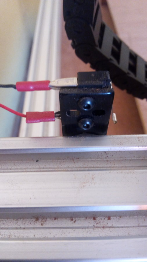

    Move your wire from the Normally Closed (NC) terminal to the Normally Open (NO) on your limit switch. OpenBuilds BlackBox 4X Documentation
    You should also set the Homing debounce ($26 in grbl) to 250

    The reason I suggested moving the wire to NO is because you have "invert limit pin" set to 0.

    Hi @Tajudeen, I think your problem may be in your grbl settings. There are people here who are far more expert than me on this but it would really help us if you could do as @Peter Van Der Walt suggested above - "paste output of Grbl's '$$' command (from Serial Console)" - it is really hard to work out what you have set from a screenshot.

    99% of the time its wired wrong
    1% of the time Grbl setting for $5=0 or $5=1 doesnt match what you have wired
    Its only one those two things.
    Compare your wiring photos to OpenBuilds BlackBox 4X Documentation(seems you NC wiring not NO wiring as recommended. Also note the recommended $5=? setting on the documentation page)
    If wiring/electronics is somethings that "hard" to you, take the easy way out and get some Xtension Limit Switch Kit

    Hi @Tajudeen, looking at the pictures you posted earlier it looks as though the first switch was wired NO and the other two were wired NC. Have you now got all three wired as NO?

    Thank you @Alex Chambers I have wired all switches in similar order. But Will check to make sure.

    So checkout these three settings against the Grbl Wiki: gnea/grbl
    $5=0 is the correct setting if you wired your switches as:
    NO = SIG
    C = GND
    $21=0 - disables limits - might want to set it to =1
    $22=0 - disables homing cycle. Set it to =1 to enable Homing
