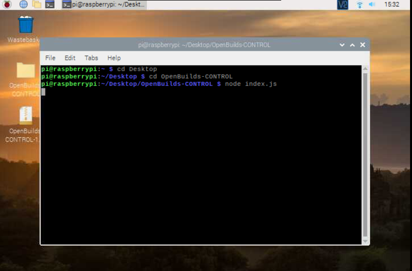

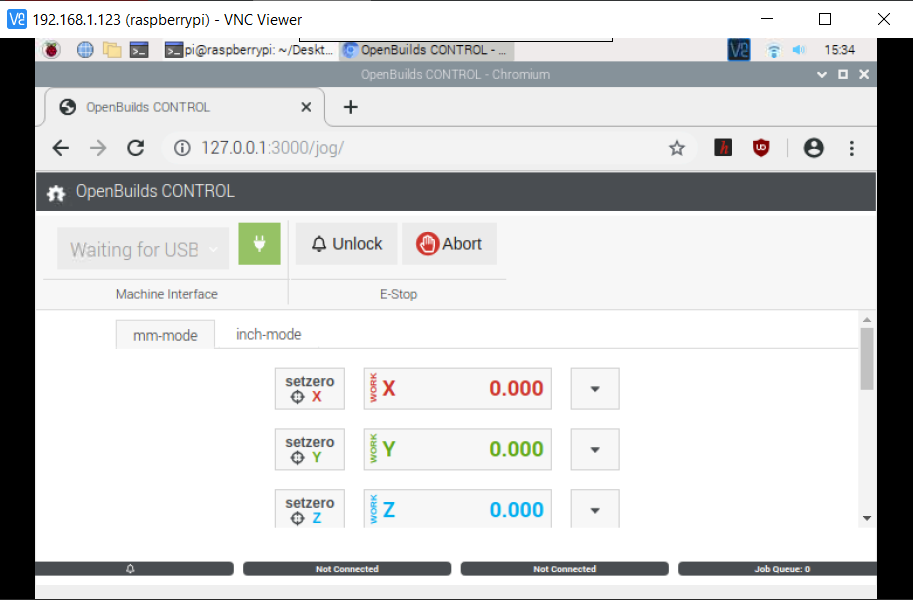

  15. damian_Poland
    Nov 10, 2017
    Hi Guys!
    I have been trying to install OpenBuilds Control on Raspberry Pi for 2 days.
    I know that the project has no official support but I give up - maybe someone can help me here.
    I did everything in accordance with the instructions.
    After using the node index.js command, nothing else happens.
    Ie the OpenBuilds Control application window does not appear.
    After entering 127.0.0.1:3000/jog in the browser window, I have access to OpenBuilds Control, however, after connecting the BlackBox board with RPI with a USB cable, I still see the message "Waiting for USB"
    I have no ideas anymore.
    I formatted SD cards, performed the installation several times and the same problem every time.

    The instructions does relate to a much older version (wiki last updated Jul; 30th last year) so could be something on control, could be Raspbian, sooo many things :)
    Only clue I can give you is to run it as "DEBUGCONTROL=true node index.js" to enable logging, see if theres any errors or clues
    Only other clue - check dmesg, is your USB device detected when you plug/unplug? and is your user member of the dialout group?
