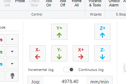

    Yes - all good! I installed the latest OBC version on my touch screen tablet and I was able to jog with no issues.
    Now I wish my UI looked like this

    That would help me avoid fat finger z crashes for sure.

    We hear you again :) but sadly on that one, we have some other plans :)
    And yes the plans will help with that too

    So i assume this affects mostly touchscreen users right? (keyboard jogging has become so stable I almost considered removing the UI buttons, but for touch, alternative accessibility inputs, etc, it's best to keep it.)
    I'd prefer to keep the XY widget looking like it does now (subtle hint reminding you that the cursors on a keyboard looks the same, thus introducing keyboard jogging)
    I have some extra vertical space (slight change to DRO introduced some space) - would adding more margin between the buttons help enough with the accidental finger accidents? We added margins on the Mobile Jog widget for same reason and haven't heard any complaints since anymore.
    And we can add some extra space between those and Z for you. Also with the Z+/- spaced further apart vertically.

    I'm willing to try out any suggestions..... I personally do not have any issues with the Y or X - just that the X+ is too close to the Z and if I am moving at 100/10 and fat finger the Z I have had the z crash before.
    I am guilty of not trying to use the mobile access.
    I know I am giving you a hard time, all in good spirit. I think any extra padding would help.
    I will check out the mobile here this weekend

    v1.0.267 has extra padding:

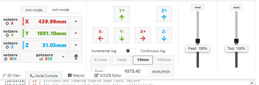

  21. sharmstr
    2,059
    1,449
    With the new padding, the tabs-holder overlaps jog speed settings. I can obviously resize the window to fix, but thought you should know.

    Will fix right away :)

    That screenshot was from my 34" desktop monitor which is 3440x1440. On my machine I run a 12.3" touchscreen @ 1200 x 1600 at full screen in portrait mode so I get more simulation area
