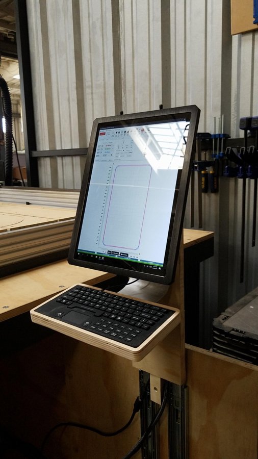

    I'll have to give the portrait view a try.... I too would like to see more simulation area. My dense brain wouldn't tell me to turn my tablet!
    What sort of touchscreen do you run? Windows? Is that what is connected to your Black Box ?
  11. sharmstr
    2,059
    1,449
    Lots of simulation area when running portrait
    Here's the display: https://www.amazon.com/gp/product/B07P9CVY47/ref=ppx_yo_dt_b_search_asin_title?ie=UTF8&psc=1
    The computer: https://www.amazon.com/gp/product/B07D77W8CZ/ref=ppx_yo_dt_b_search_asin_title?ie=UTF8&psc=1
    And yes, connected to the blackbox.

    Dang that looks great! I'm going to explore this... question for you..... the curved mount for the monitor is that something you had or bought?
    Also, what sort of keyboard is that.... wifi/bluetooth, seems nice and compact - would like to find it on Amazon if possible.
    I put my tablet into portrait mode today and while it gives lots of simulation space the size of my tablet is not wide enough (11.6" x 7.5") so then the Tool slider wraps down.
    I am hoping I can find a touch screen that is larger but not too large and then do the micro pc like you have with the keyboard.
