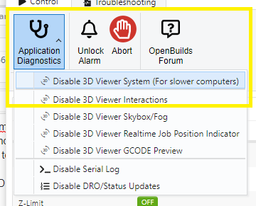

    any idea why prior to the update to 1.0.273 i could see the 3d Viewer and now i get this error on the same computer running an Nvidia GeForce GTX 850M. "No WebGL Support found on this computer! Disabled 3D Viewer - Sorry!"
    Standby as i update to the latest driver...

    Probably not related to the Update (Refer changelog: OpenBuilds/OpenBuilds-CONTROL )
    Double check that 3D viewer is not accidentally been disabled on the Troubleshooting tab under Application Diagnostics

    THanks Peter, that's the first place i checked and bounced it on and off a few times to no avail, my driver is from 9/20 and the latest if from last week so hopefully it will change something.

    Thanks! just installed 270 and it is there now! but i love updates...lol
    ok here is something even funnier, 2.70 detected the update to 2.75 and now 3d Viewer is back, not sure what is up with 2.73 but it was not detecting 2.74 yesterday
