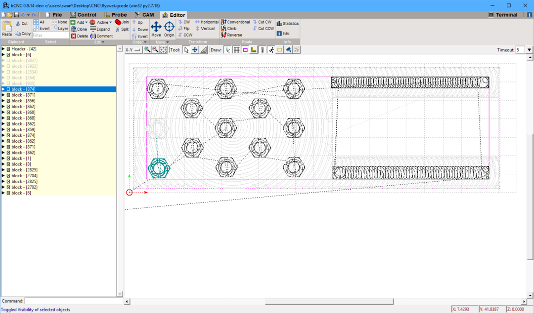

    Hi, is there a way to resume a job that oh i don't know got accidently aborted due to someone tapping the limit switch an hour in?....
    edit: just found the macro section, now to see if there is one.
  11. Peter Van Der Walt
    Builder Resident Builder
    15,699
    4,510
    Only by hand editing the gcode (It needs a human to read, interpret and understand what to edit/add)
    - You need to bring in any modals that was set earlier in the job (coordinate systems, in/mm, plane, relative/absolute, spindle, feedrate, etc)
    - You need to write position moves to correctly position machine before entry into the first line of gcode
    - You need to make sure it won't crash

    Yikes!, so it's pretty difficult but not impossible for the software to read the gcode line it was on and save line on abort, and then after alarm is cleared ask for a confirmation for abort or resume?
  13. Peter Van Der Walt
    15,699
    4,510
    Not quite, because when the abort happens, you've lost position, the modals are reset, etc.
    Yes, software can do it, but we'd rather not take the responsibility just in case - with a supervising human taking responsibility... its not our fault

    Grbl has several moves in a buffer, after the abort we clear that queue and aren't entirely sure how much of it did complete - because we keep the Planner full. Almost none of the Grbl hosts attempt to offer this feature, its just too risky

    the 'easy' way is to use the editor built into bCNC. first install bCNC (with Python2.7) (does not have to be on your control PC, since you are not going to controll the machine with it)
    open the gcode
    select the Editor tab
    untick the block that have already been cut.
    save the file.
    transfer to controller
    cut.....
    here I have selected all the greyed out blocks up to and including the first hexagon cut that is highlighted in teal. you can click on a block and it will be highlighted so you know what is getting cut in each block.
    Sonicboom and sharmstr like this.

    Thanks David! , I will try that this weekend great tip!
