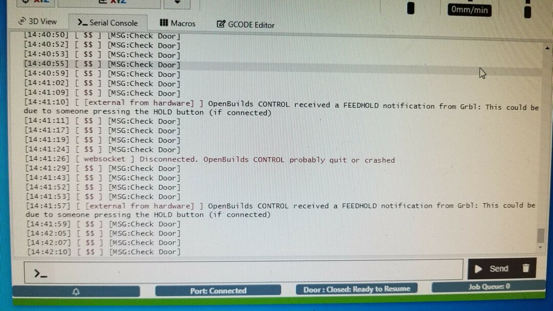

  24. JustinTime
    JustinTime Veteran
    Dec 18, 2013
    784
    260
    Thanks, that was helpful, I now have it disabled and was able to update Control to 'Arduino Nano with Door switch NC'.
    Now, when I start Control and connect to the Arduino, I get the 'MSG: Check Door' even though the door is closed and it repeats itself every few second and I can't do anything with Control. I know it's closed because when I open it that message appears rapidly many times a second for ever until I close the door. When I close the door it returns to the every few seconds interval and I still can't do anything and every few messages I get the FEEDHOLD warning and another message as can be seen in the attached picture. Also, as can be seen, the door is closed.
    I have connected the Door switch to the Hold pin, as I saw mentioned a few places. Is that the correct pin or not?
  25. Peter Van Der Walt
    Builder Resident Builder
    15,699
    4,511
    use the troubleshooting tab to check your wiring. Make sure you understand the logic (triggered = door open)
    Dont forget to use quality switches like our Xtension switches (which are NO by the way) with filtering
  26. JustinTime
    JustinTime Veteran
    Dec 18, 2013
    784
    260
    Now that you've mentioned it I realized I forgot to put the filter on that switch. I had it on the limit switches. I'll put the filter on it and we'll see if it fixes it.
    While at it, I wonder if I should also put filters on the probe and spindle control output pins or are they not needed there?
    #1856 JustinTime, Apr 25, 2021
  27. Peter Van Der Walt
    15,699
    4,511
    Probe yes, spindle no.
    JustinTime likes this.
  28. JustinTime
    JustinTime Veteran
    Dec 18, 2013
    784
    260
    A few hours after I posted the question it occurred to me that the Probe is input and needs filter and the spindle is output and doesn't need.
    I installed the filters and now it runs with no errors. I opened the door and expected the Z axis to go up but it didn't. On the other hand, after I closed the door, I pressed the run button twice and the program continued from where it stopped. I didn't expect that but I like it.
