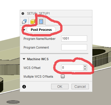

    I have a question regarding multiple work coordinate setups...At least I think that would be the right term for what I'm trying to do...
    Here is what I'm using:
    - C-beam XL
    - GRBL 1.1 on an Arduino Uno
    - Openbuilds Control software for Linux on Ubuntu
    - Openbuilds XYZ Touch Probe Plus
    - Limit switches, with home set to the bottom left corner, Z up.
    My spoilboard consists of two main work areas, one of which I attach stock in various locations depending upon the task being performed. The other work area has an affixed piece of HDPE that I have machined to specific dimensions, and has holes to bolt stock to, so the stock position is always relative to what I consider the work coordinates of that station, the bottom left corner. My workflow has been to home the machine with the limit switches, then affix the stock and use the XYZ Touch Probe Plus to set work zero. This work zero changes in the first work area depending upon the stock location and height, but it is is always the same for the station that I have set up with the HDPE platform. So basically I'm using the touch probe to set work home for both areas, but it would be much more convenient to set the unchanging work zero once and use it as necessary. Is there a way to store the location of the zero for this station, without having it reset each time I reset work zero? Thanks in advance.
  9. Alex Chambers
    2,834
    1,393
    Yes - you have multiple Work Co-ordinate Systems. Can't remember how many grbl allows you, but the first (and default one) is G54. You could use the next one (G55) for your fixed workplace. To set the workplace zero for G55 just send that code (G55) and set the workplace zero as normal. Grbl will remember that position relative to your home position so if you home, send G55 and "Go to Workplace zero" it will go to the same place every time.
    Workplace co-ordinate systems are modal - that means that having told grbl to work in one wcs it will stay in that co-ordinate system until you change it.
    In normal use the wcs you want to use would be set in your g-code by your cam software - what are you using?

  16. Aeneas
    Aeneas New
    Sep 7, 2016
    70
    Oh, gotcha. Fusion 360 with the Openbuilds post-processor.
  17. Alex Chambers
    2,834
    1,393
    Easy then - just choose the wcs you want to use for a particular job in Fusion cam setup.

  18. Aeneas
    Aeneas New
    Sep 7, 2016
    70
    So would I use the touch probe, get the numbers from the readout in the Openbuilds control, and use those numbers to set G55 or whichever in Fusion?
  19. Alex Chambers
    2,834
    1,393
    No - just use Openbuild Control to send G55 to change to that wcs, set your workplace zero exactly as you normally would. Grbl will remember that place (assuming of course that you homed your machine first). Then when creating a Fusion cam setup you put 2 in the wcs box - Fusion will put G55 in the header of your g-code file and run the job in that wcs. Obviously you will still need to set Z zero for any particular workpiece.
    Aeneas and Peter Van Der Walt like this.
  20. Aeneas
    Aeneas New
    Sep 7, 2016
    70
    So that's the part that I'm not getting. Would this require entering text commands in the interface? My knowledge of using this control goes about as far as using the GUI and the probe to find the coordinates to set the zero.
  21. sharmstr
    2,059
    1,449
    @Alex Chambers @Aeneas I havent tracked your entire convo, but the openbuilds probing routines specify G54. Keep that in mind.
    There are a few ways to work around this, but here's what I do when I want to set the work zeros for something other than G54.
    Home my machine
    Probe the stock setting my work zeros which is in G54
    After probing routines are done, dont move the machine at all and either make a mental note or jot down the current X, Y and Z dro values.
    Click down in the serial console and type in the coordinate I want. In this case G55. Then click send.
    Now the machine is in G55. The X, Y and Z values have probably changed.
    For each X, Y and Z value, click in the DRO, type in the value you jotted down for the axis. Instead of pressing enter, press Shift + Enter to set the value.
    Now, make sure when you cam your job, that you give it the correct WCS in your setup. In this example that would be 2.
    To get back into G54, just type in G54 in the serial console and click send.

  22. Aeneas
    Aeneas New
    Sep 7, 2016
    70
    Thanks for the reply.
    I'm not able to get it to work exactly like that. When I use the probe to set my work home, the DRO values are all set to zero. Then when I enter G55 without moving the machine, I get coordinates which are an offset of my home location in the DRO. I then clicked in each field and pressed Shift+Enter. My thought was that may have set the WCS appropriately, but when I changed the GCode to G55 through Fusion, it sent the router into the +Y limit switch.
  23. sharmstr
    2,059
    1,449
    But did you also change the value to 0 before clicking Shift-Enter?
    Edit: Just tested on my machine and it works. So either you didnt home first, didnt repost after you changed to G55 in fusion, loaded an older file that has G54, or didnt change the dro's to 0 after putting the machine in G55.
    You also mentioned that after probing your machine was at 0. Depending on the probe you did, at the very least z should not be at 0. It raises the bit up after the probing completes.
    #1943 sharmstr, Nov 30, 2021
    Aeneas likes this.
  24. Aeneas
    Aeneas New
    Sep 7, 2016
    70
    The first time, yes. It sent the machine in the direction of the axis the specified distance. That was with holding shift and pressing enter.
    To clarify, I homed the machine, placed the XYZ probe plate where I want my G55 work home to be. I then ran the probe functions, which set all the values on the WCS to zero. I entered G55, and the DRO values all changed, for instance X was 238.87mm. I then clicked in that field, typed zero, held shift and pressed enter, and the machine jogged in the X direction and arrived at zero.
    Regarding the Z position, I don't use the auto probe function (is that what it's called?) as I want the best approximation of zero that I can get, since the rotational position of the endmill won't likely be a true diameter of the endmill. I use a pin gauge for X and Y, then I change to the cutting bit that I will be using and probe Z. Then clicking on the first home function in the drop down moves the bit to all zeros.
