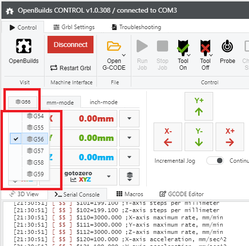

    v1.0.306 is available - give that a test by probing in G55-59 and see if that works?
    Aeneas and sharmstr like this.

    Update to the latest version. Peter changed the probing routines so they will set the current WCS. In your case you would now:
    Home
    Switch to G55
    Probe
    Easy :) You'll just have to mentally keep track of what WCS you are in. We've had a chat about adding a WCS display. But for now, if you cant remember, you can always re-issue a G5x command or issue a $G command which will tell you your current WCS.

    @sharmstr @David the swarfer @Alex Chambers @Aeneas
    New in v1.0.308:
    Added a little button top, left of the DRO. Shows current WCS. Clicking it opens a menu where you can switch WCS
    v1.0.307 also fixed the Probing macros to set zero in the "current WCS" (it was forcing G54)

    That's great. I love the WCS display and ease of switching. I did run into a problem when using this version though. After homing, switching to G55, then moving to that zero, I ran a cutpath. The job ran ok initially, but I got GRBL error 25 - A GCode word was repeated in the block. The job continued until I acknowledged the error message, which gave me a message about loss of position (the same one that you get when you hit a limit switch) and then stopped. It is possible that the GCode is the problem, but I used version 1.0.307 and it ran fine. I've also used the code in other versions, with the only change being that this one uses the new WCS.
