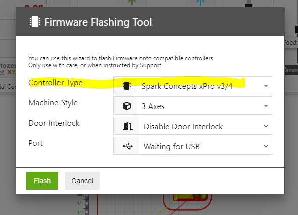

    What controller do you have?
  2. Noah Carlson
    Feb 15, 2022
    I have the Spark Concepts xPro V3, but it is the old version set up for GRBL v0.9. Is there any way I can update it, or am I stuck with buying a new card?
  3. Peter Van Der Walt
    15,691
    4,493
    OpenBuildsCONTROL > Wizards and Tools > Firmware Flashing Tool
    Select the xPro V3 from the list, rest defaults, select the correct Port and Flash
  4. Noah Carlson
    Feb 15, 2022
    I think that fixed it, thanks for the help.
