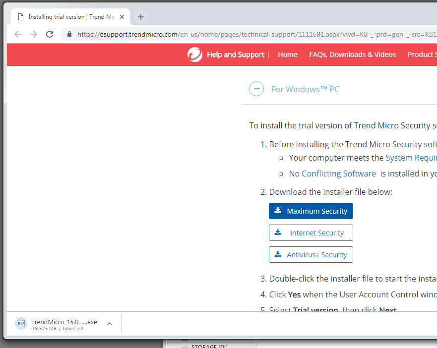

    Looks like the software is trying to change some files. So the anti-ransomware in Trend is kicking in.
  30. Peter Van Der Walt
    Builder Resident Builder
    15,699
    4,511
    A shame the log doesnt print the paths to those files, as it could very well be our own installer extracting updated html/png/asar files over the older version...
    I'm going to bet Trend is just overparanoid :) never been a fan of it for many reasons.
