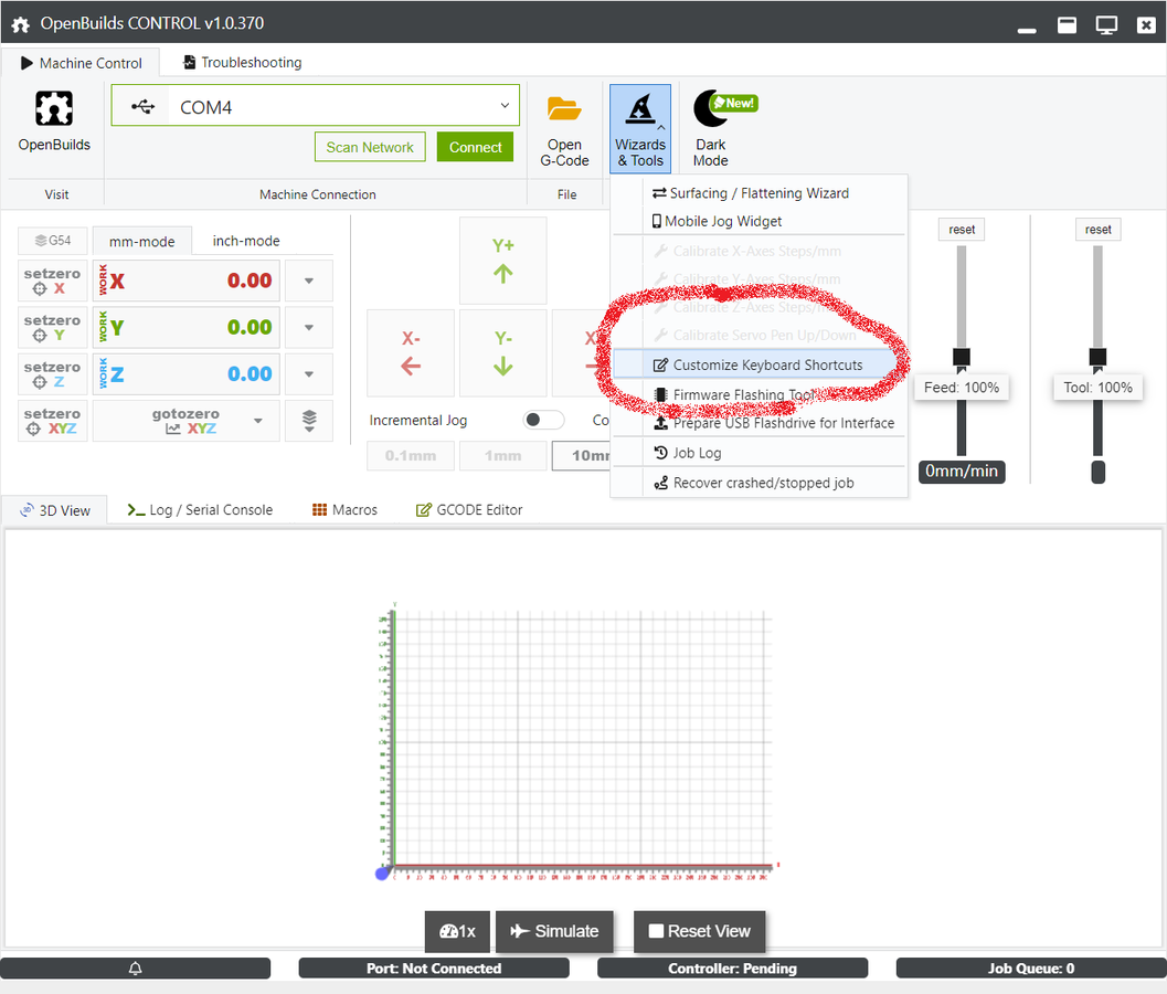

    Is it possible to change the shortcuts for the jogging etc?
    I messed up a job hitting the down-arrow on the keyboard... My bad!
    Thanks again for the great software and controller.
  29. Misterg
    Misterg Veteran
    Aug 27, 2022
    429
    332
    Yes - go to 'Wizards and Tools' then 'Customize Keyboard Shortcuts'
    (I did exactly the same thing - well broke a tool, anyway.)
