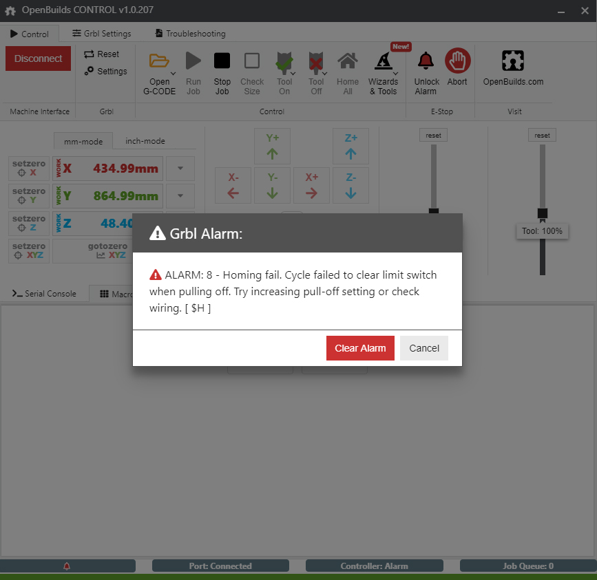

    OpenBuilds Controller does not connect to the machine workbee100150cm (using Black Box controller)
    Everything worked perfect and now I'm trying to connect the machine - that's what happened - attaching PRTSCRN . (from openbuilds controller)
    Thanks for help.

    Drop an email to http://support.openbuilds.com/support/home they will sort your out with an RMA request for a replacement Brains board. Refer to this thread in the email to help the process along quicker :)

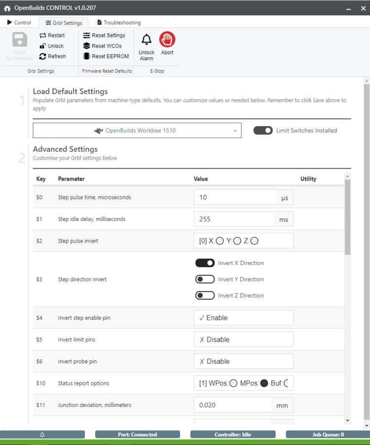

    Hi again, Peter; just receive my new brain for the controller. It fixes the problem thanks a lot.
    but now I have another problem in the software settings (open build controller)
    when I choose the option - HOME ALL > it is moving in the correct direction but stops in the mid of Y-axis and I got the next message from the software
    (attaching PRTSCRN + PRTSCRN FROM THE SETTINGS PAGE)
    Thanks for help Yanai

    1) Read through gnea/grbl (that wiki is a goldmine) - read all the settings is many relate to this issue ($5, $23, $27 and more)
    2) Use the troubleshooting tab first to make sure your switches are wired correctly
    In you case seems switch is either triggered before you even move, or, is getting false triggers (EMI?)
    Consider upgrading to Xtension Limit Switch Kit to solve false trigger issues

    Hi, Peter how are you? I'm feeling a little bit lost still got the same problem after replacing all the limit switches. (Machine Stop in the mid of Y-axis when I'm doing Home Position)
    I'm sure its problem with software but don't know what to do.
    I'm attaching PRTSCRN of my troubleshooting Page and also all my settings page.
    Thanks for help.

    11.jpg shows Y limit switch that is active.
    Were you pressing it at the time? Or is it shorted in wiring?
