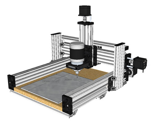

    @technerd, attached below is a small design I worked up a while back that you might take a look at. It has a similar footprint to a C-Beam Machine but uses a fixed bed and is a much more stout machine. The base mechanical system will run about $120 more than the C-Beam system. (I am currently building a larger system that traces it's roots back to this concept.)
    Edit: Attached files removed due to inaccuracies. See revised files in post below.

    @Rick 2.0 this is looking like the winner. I keep getting drawn to the larger machine since it is better value with the sale going on. I think this one is a nice starter.
    Looking to get my order in quick (while supplies remain). Any other recommendations? I figure getting NEMA 23, Black Box, Dewalt or Makita router.

    @technerd, I took another look at the design and made a couple updates. The router mount was shown incorrectly in the original version and I revised the way the upper rail is attached to the vertical stanchions. This latter change adds two more Cast Corner Bracket to the design but simplifies the mounting process.
    I also went back and reviewed the shopping list. The attached revised list shows the correct T-nuts (I had originally selected M3 nuts), revises screw quantities, and adds a few items overlooked in the original cursory review (spacers, router mount brackets, etc.).
