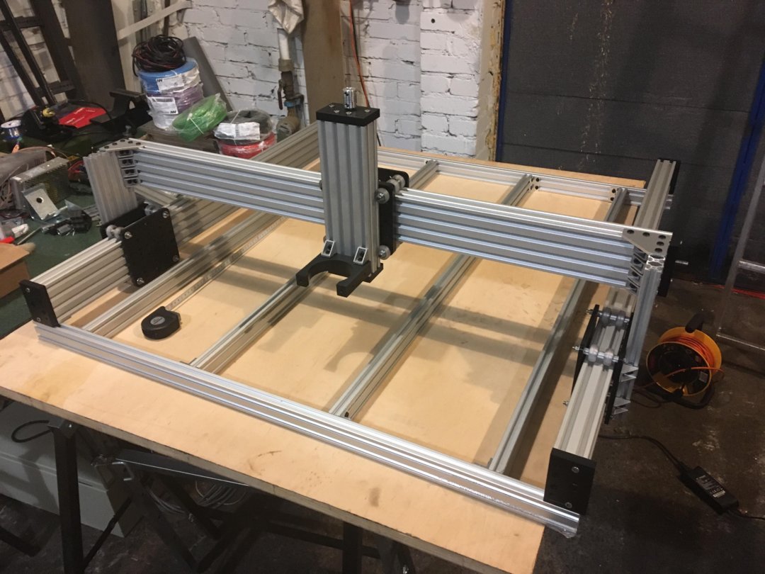

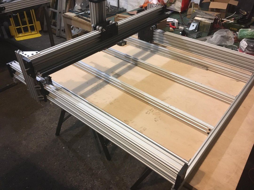

  1. GrayUK
    I don't know what the Lead has in the way of feet designed for it, but I've put 8 adjustable ones on mine. Each corner and then down the Y lengths.
    I don't trust the surface strength of the table I built for it, :rolleyes: so I thought I'd build in a reasonable amount of adjustment to make sure. :)

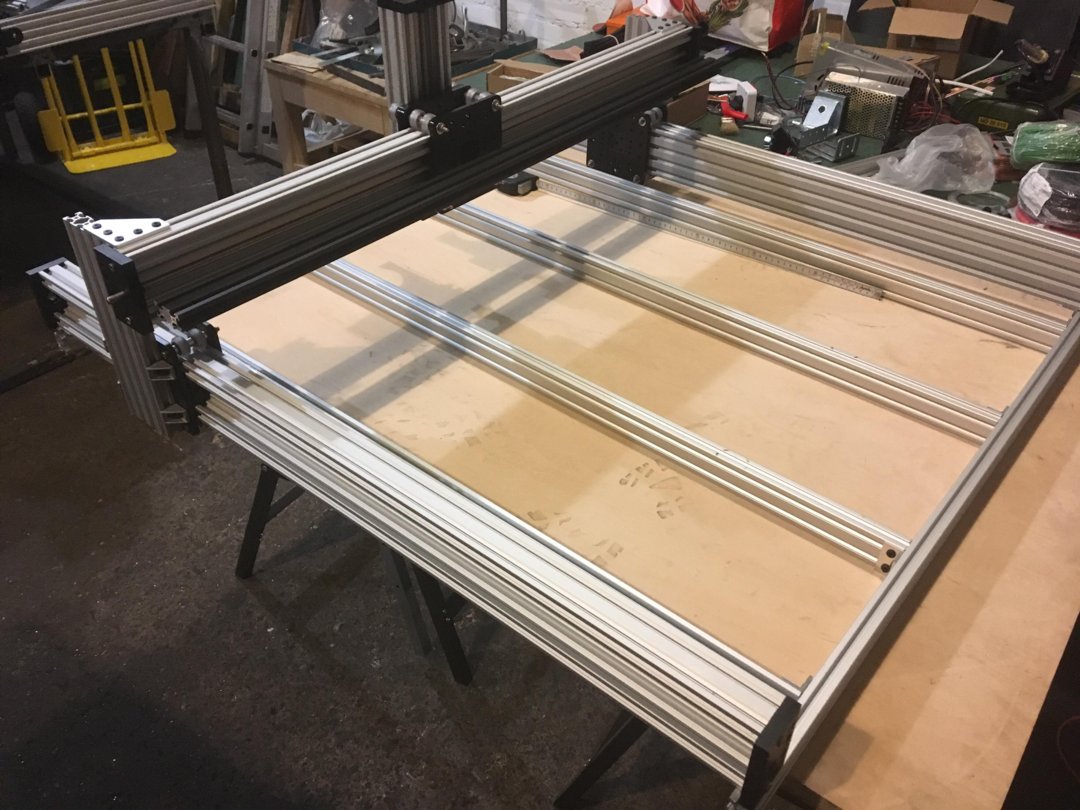

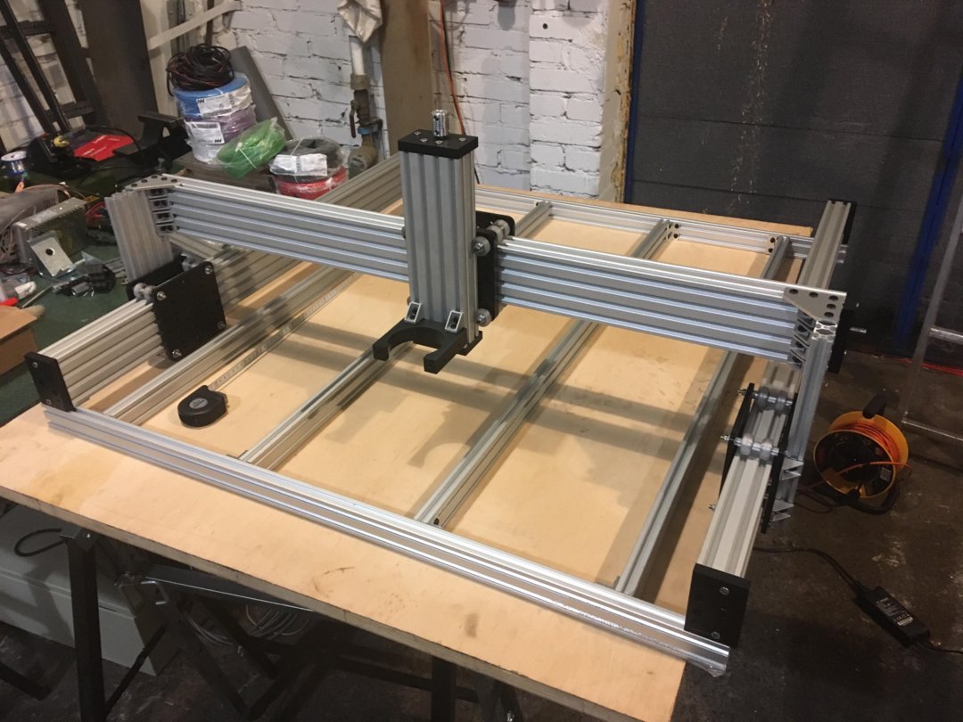

    Yeah! I am not sick anymore :) So I was able to start with it, after 2 weeks in bed.
    Now I need to choose which spindle to buy.
    52366964_393393014770358_5246238982253051904_n.jpg 51782129_370324303747422_7034769342625480704_n.jpg

    Glad your feeling better brother the LEAD is Looking great wojak! :thumbsup:

    I'm about to install t tracks as well on my LEAD. Did you consider the depth of the track into the MDF and if it would get in the way of surfacing the spoilboard (MDF) over time? How many mm below the surface of the spoilboard did you recess your tracks?
    Finally, what was your approach to cutting the track slots in the MDF. Did you use the CNC or remove the spoilboard and do it manually with a router.

    I haven't gotten this far with mine yet (I'm still hung up on some frustrating and/or puzzling tramming issues), but one approach I'd seen to this was to inset the tracks into one sheet of MDF just below the surface, and then glue another on top to use as the actual spoilboard (either mount it in pieces between the tracks, or as a solid sheet and then CNC the slots - assuming your tracks are aligned closely enough to your axis). Then, when you've eventually (re)surfaced the board so many times it's getting close to the tracks, just drop a new top layer on & repeat. The obvious drawback is that the thicker you stack up your spoilboard, the less Z travel you get, and that's the one dimension the machine already feels a little cramped in..
    My preference would be to CNC the slots in situ, after the board is already mounted on the machine, since it would guarantee your tracks will be aligned to your X and/or Y axis. Obviously that alignment isn't essential, but I've found it often makes life easier - especially when you've got a toolpath that uses almost the entire available stock, or are using expensive materials and want to minimize waste. If you're able to line up one or two existing edges of the stock with your X & Y axes, you can sometimes get away with just taking a skim pass along those sides to clean up.
    -Bats

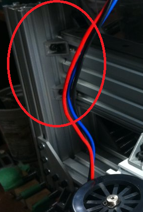

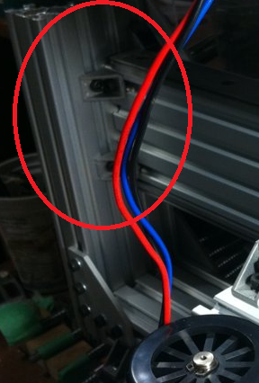

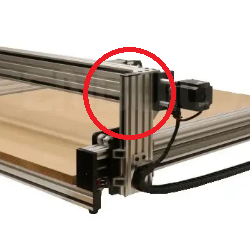

    So how long has OpenBuilds been using a 20/80 aluminum channel for the vertical connection on a moving gantry? When I did roughly the same thing, except, using a 40/80 C beam piece, I hadn't seen anyone do that before me.

    If you look back through the old CNC designs you'll find this is not a new concept. There are a number of examples over the years. The Routy which was pretty much the first design actually used 20x40 verticals.
