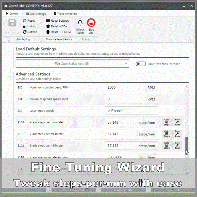

    Doing a little fine tuning on my Lead1010. If I tell it to move 100mm, it moves 100.42mm. Is that little difference worth worrying about? We aren’t making anything precise, mostly just signs and such. That extra .42mm is just bugging me though, lol.

    Be sure to check out the new wizard in the OpenBuilds CONTROL software
    Also be sure to check out the post Things you didn't know about the OpenBuilds CONTROL Software for a lot more really cool useful feature of this powerful software!
    10. Fine Tune your Steps per mm values
    OpenBuilds CONTROL comes with an very easy step-by-step wizard to help you calibrate the steps-per-mm values of your machine, to ensure highly accurate cuts

    Thank you Mark! That makes things super easy.

    Well that took all of 10 minutes . It’s dead on now in all directions.
