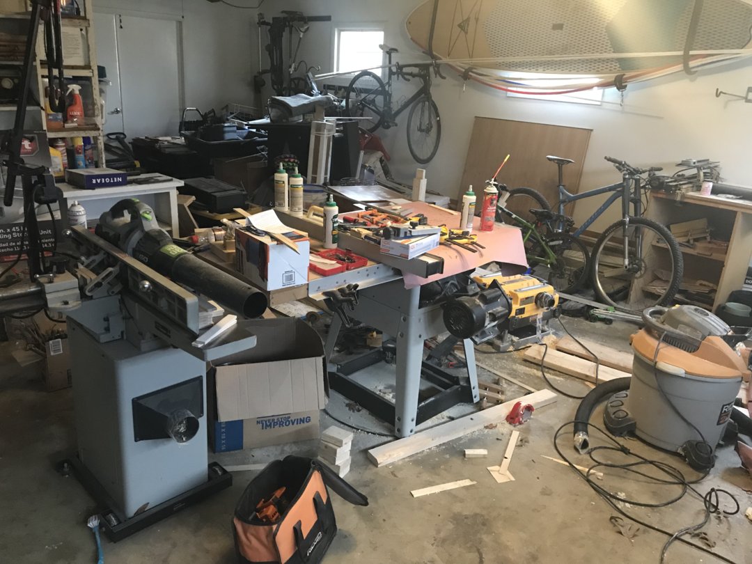

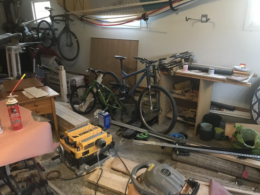

    Hey, at least you have a planer! That's one luxury I still haven't found the space (or budget... but mostly space) for yet. Initially it was one of the many tools I figured I could take the place of with a CNC rig... only to discover that it was one of the many tools that're really needed with the CNC rig.
    But here are the sawhorses you asked for (and a whole mess of other crap you didn't ask for):
    This is about half (or maybe a third? it seems to expand whenever I turn my back, like some sort of fungus) of my disaster area "shop". Out of frame to the right (past the disassembled mill column) there's a little wood lathe (a Delta midi) and (next to the drill press) a wobbly little bench with a grinder & Worksharp for the chisels, and (on the opposite wall) a vacuum pump for resin stabilizing/dying wood and convection oven (mostly for resin curing, with the occasional attempts at tempering steel and heating snacks). On the other side of the red tool cart (on the wall opposite the Lead) is the metal lathe (South Bend Light 10) with a bandsaw & air compressor tucked in awkwardly around the furnace. The scrollsaw, main workbench, and electronics stuff are in the "bedroom" I'm standing in the doorway of.
    The (half-width) Lead is sitting on a (strictly temporary) MDF tabletop made from two layers of .75"x11.25"x48" MDF "shelfing"(sic) (my main source of junk-grade MDF, since at $2.92/ea they're dramatically cheaper than buying the stuff sold as lumber) - the upper sliced & laid crosswise - topped with a sheet of 1/2" x 2' x 4' MDF ($13 - see why I use the shelfboard? this stuff also stunk up the car and the whole basement before I slathered it with watered down Titebond), all of it glued & screwed together. MDF isn't much good at keeping its shape under load in the long term, but it's sturdy enough for the moment, and with the Lead clamped to it, the weight adds a bit more stability (or at least solidity) to the machine.
    Things get even hackier as you go down. The MDF is sitting on top of some 2x4s lying across a pair of collapsible sheet steel sawhorses (which I think I got a 2-for-1 deal on, back when I picked them up to definitely-only-temporarily hold up the previous CNC contraption several years earlier). The front 2x4 has an old shelfboard fastened to the front as a keyboard & trackball stand (I've got a tiny slide-out USB keyboard pulled from an industrial copier that's waiting to replace it whenever I get a proper table built), with an old XP box in a 2U rackmount case (water cooled & with "filters" stretched over all the air inlets) hung underneath. The plastic sheeting stretched over the sawhorses either protects the vents on top from getting piles of chips & dust from getting dumped on top of them, or seals said vents shut with the weight of said chips & dust on top of the plastic (although this is less of an issue with the MDF surface on top than when I previously had the Lead sitting directly on the sawhorses & dropping all its debris straight down).
    Then on the floor there's the shopvac, the 5 gallon "reservoir" for the water cooled spindle, and a completely unrelated vacuum furnace, mill vise, cute homebrew aluminum "lathe", and random motors. I think there may also be an accordion peeking out from behind the curtains under the old board games. The plastic sheeting (currently pulled back) can be dropped down to enclose the whole area with the CNC, wood lathe, and grinders (with the mill potentially inside or outside - not sure yet how that'll work in practice). It's hung from the edges of an overhead storage loft full of decades worth of old Christmas decorations, which is also useful for hanging tools, supporting the power & water lines to the spindle, and keeping me in touch with my surroundings by means of frequent concussions.
    Not shown is the shelf with gallons of flammable solvents and propane bottles sitting right next to the CNC machine that would almost certainly never think about igniting its own spoilboard out of spite. Again.
    The superfund site in the foreground is the mill (or parts of the mill) I've been struggling to clean and reassemble. It was actually going really well, if slowly, right up until I got to the spindle (the casting for which is visible sitting on the Lead's tabletop). At which point it started going really not-well, and is now at a bit of a dead end until I can get someone to give me a hand welding/plating/remachining the spindle and then regrinding the taper. Today I'm trying to do a little final scrubbing, then oil & put everything else back together, so maybe I can at least get back to (or near) the Lead. Or at least that's what I would be doing, if I weren't writing this to avoid it.

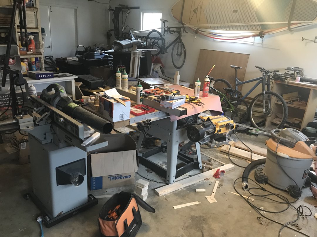

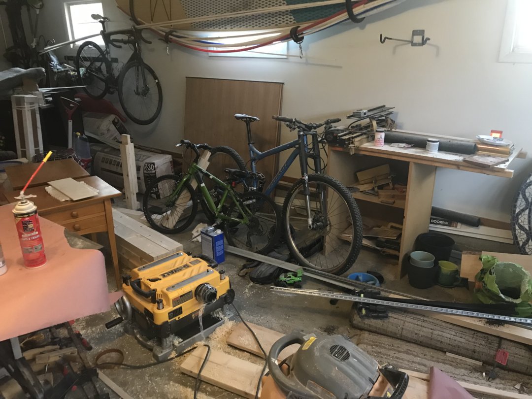

    559144F5-97EE-406F-8E00-096AAA1DBF2F.jpeg 3CC16138-CF34-456B-AB0C-30C80EBF7AC8.jpeg My workshop.. guess I'll pickup q couple of saw horses, 2 sheets of 3/4 MDF and laminate the sheets to get a solid stable base at least, then I'll build a frame later.
    There is a Jet mini lathe in there somewhere as well.

    Look at all that... space!
    And tools. Tools are good too. I think I see a jointer under the leaf blower, and maybe a table saw under the clamps? Two things I desperately need, but have yet to find space for (err... the jointer and table saw. I can live without the leaf blower. the clamps, though... more clamps are always good).

    Yep, Table Saw and Planer, thickness planer on the floor. This is a large 2 car garage with a huge area in the back, I could park 2 cars end to end on one side. That area is ultimately my workshop. I still need to fit the cars in there, although since I am working on the bathroom, what was not in the pictures was my tile saw and stack of tile, and plumbing crap.
    The Jet lathe is indeed a wood lathe. It's the Jet1015VS (JWL-1015VS 10'' x 15'' Variable Speed Wood Lathe) I plan on getting the extension bed at some point.
    As for the blower.. uhh.. my shop vac does a crappy job.. so what it does not get.. I use the blower to just blow outside.. I mean it's just tree dust after all :)
    Once I am fully setup (I only moved here a year and a half ago, tons of home improvement projects, still have not even completely unpacked yet lol), I want the CNC on a mobile base that I can pull up and out of the way. maybe used clamps to hold down the base of the CNS to the table, then hanging pulley system to pull the cnc out of the way up to the ceiling. I don't think flipping it up vertically would be good for stresses on the gantry.
    What you missed.. the bicycles :) cumulatively cost more than some peoples cars :) I won't give exact prices, but uhh.. north of 10k, less than 20k :) Lets just say I spent a few weeks on teh couch after making those purchases.. better to ask for forgiveness than permission :) ps.. I have security cameras.. :)
