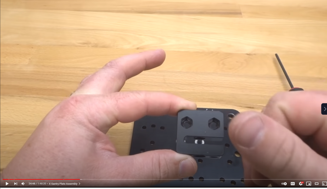

    I suppose it's good I stopped and noticed a disassembled anti-backlash block in my bag. The assembly video doesnt show anything about assembling it let alone setting it during the build and it looks like they are using an empty block- I know that cant be right and probably wont be happy if I assemble the rest only to find out I have to take everything apart to redo it. Any help with this? Pictures even?
  4. Ancientwollf
    Jul 29, 2017
    Update- I did find this video. Need to note it in the videos guys...
  5. sharmstr
    2,059
    1,449
    It shows the install of the anti-backlash nut at the 24:00 mark of the install video.
  6. Ancientwollf
    Jul 29, 2017
    I was pointing out the tension screw and nut are not assembled or referenced in the video.
