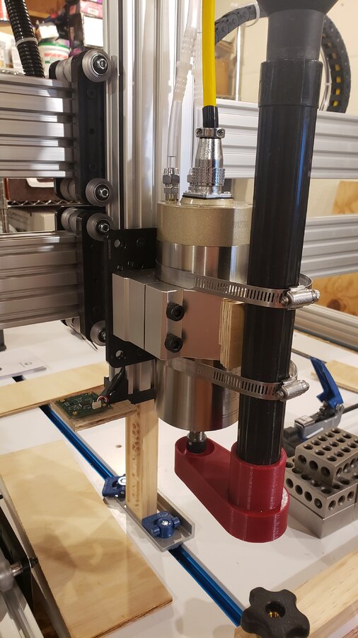

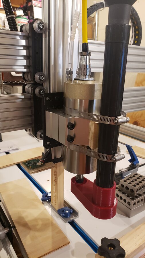

    Some more spindle porn.....
    1.5 kW, water cooled, 24k RPM, ER-11 collet size (1/4" shank), High Z kit. Added camera for positioning.
    Turned the C-beam around so it is doing the movement.

    I'd love to see some video of your dust "bootsie" in action :) that is so nice and compact, how well does it perform?

    The picture shows no tool in the collet. I now have a 1" flycutter in there to level the spoilboard (next assignment). The bootie works just fine. I came up with that design and 3D printed it at home. It works great for what it is and it is improved when i cover the top part of the hole with tape. It picks up just about all of the fluff coming off the mills. Plus, with the height being adjustable, I can position it where it is needed for height reasons. Nice thing is that there is no brushes on it dragging on the work. I need to improve the mount to the spindle with some radiused out mounts but they are to be made after the spoilboard is leveled.
