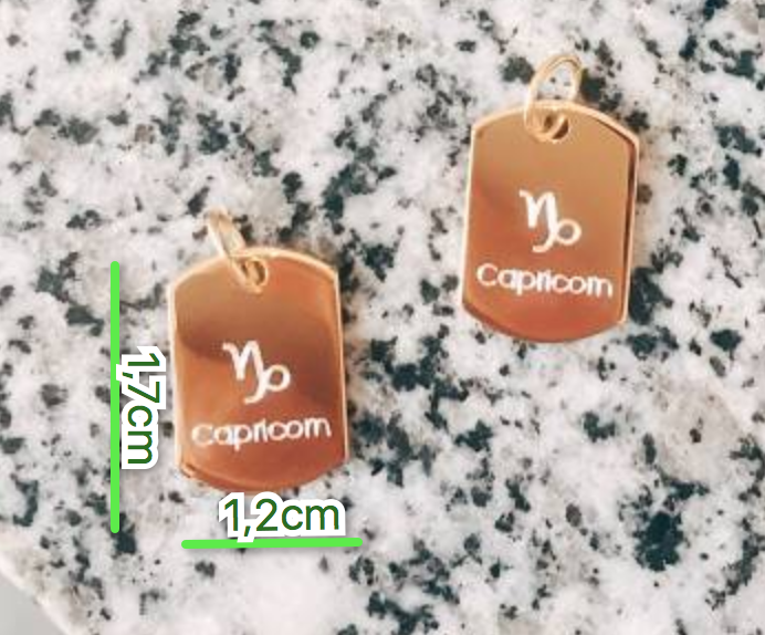

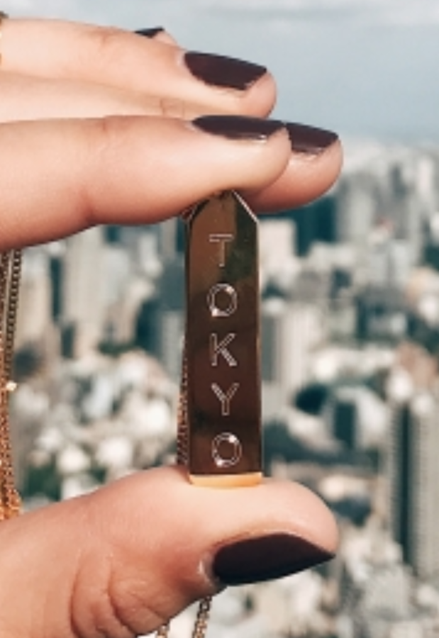

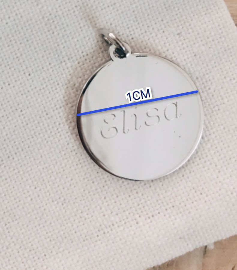

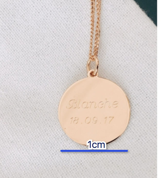

    Hello,
    I would like to buy the MiniMill but I've doubts about its accuracy to engrave jewels.
    The description mentions a accuracy of 0.05 to 0,1 mm. Is it enough to make engraving as you can see on pictures below ?
    Did anyone engraved jewels with the machine ? Can you send me pictures ?

    The MiniMill, thanks to it's small travel, is a great machine for engraving.
    Take a look at some of these examples made on the MiniMill....some of it depends on your bits, material, speed, number of passes etc. Both of these guys have great Instagram feeds worth exploring.

    Additionally if you need to improve resolution even more you can always install lead screws with a smaller lead. (i.e. TR8*2, TR8*4, M8x1.25,etc.)

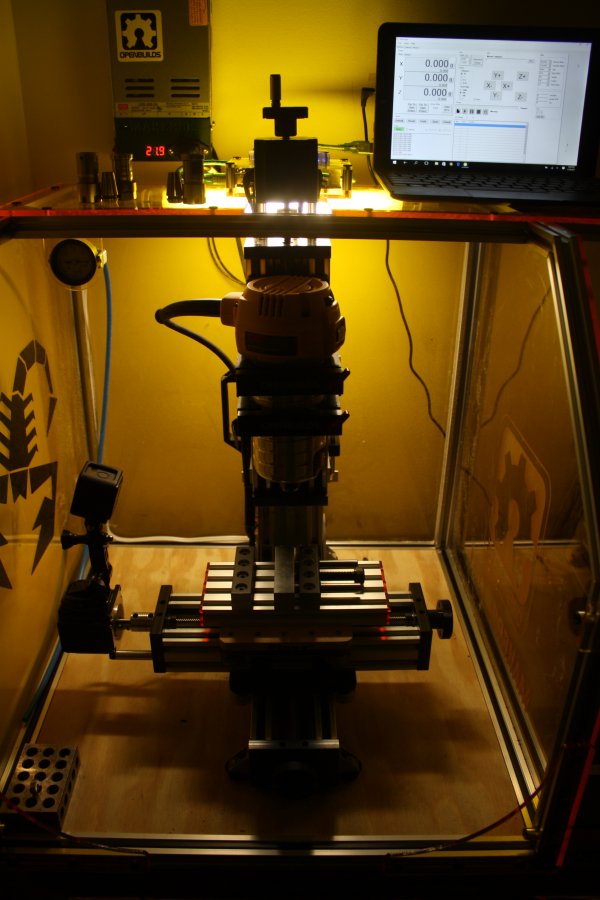

    How did you make that enclosure? That is awesome.

    Did you design the limit switch mounts, or did you find them posted somewhere? I like the design of the them, would you consider posting a link to them?

    What spindle and rpm are you running, and what tool are you using? I really like the way your setup is working!!
