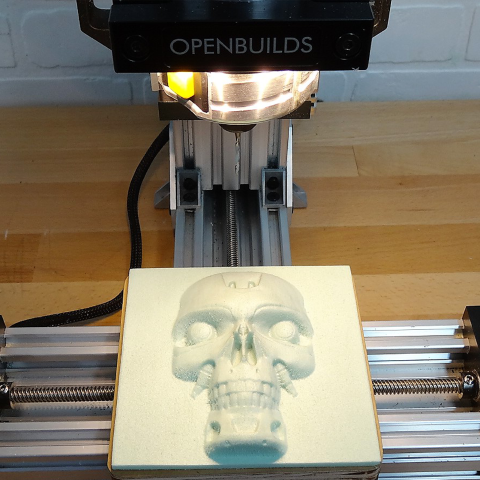

    3D Carving!
  8. Rick 2.0
    2,904
    1,559
  9. MaryD
    MaryD OpenBuilds Team
    Apr 13, 2016
    649
    639
    Good eye Rick. We are releasing a new LED light ring very shortly....

    This is a great example of the true 3D capabilities of this little machine, it is the very thing that drew me to it in the first place :thumbsup:
    Very cool project, I cut a few very similar skulls around Halloween last year...too much fun :D
    Can't wait to get my hands on one of the LED Rings...

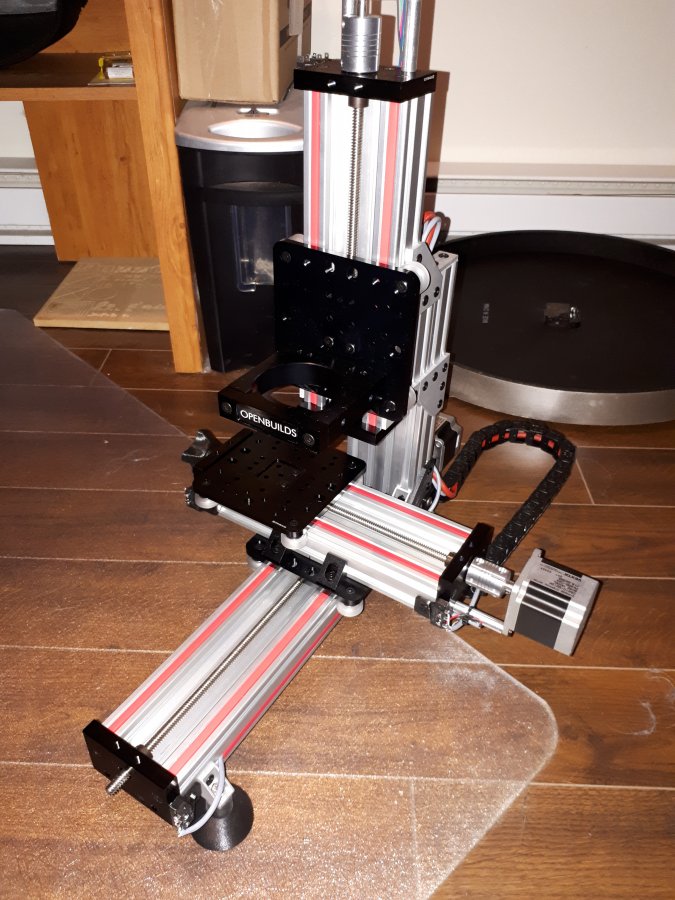

    Yesterday night spare time investment :)

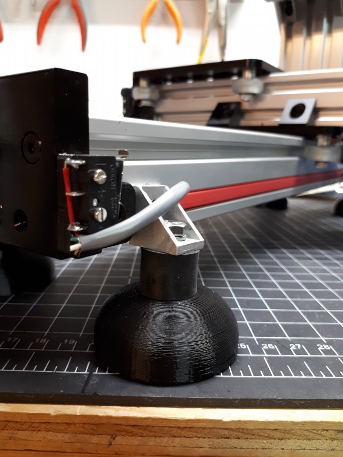

    Printed some feet on vibration dampener:

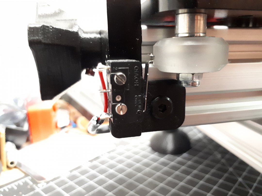

    Printed some limit switch mounts (X-, X+ (mirrored) and Zup):

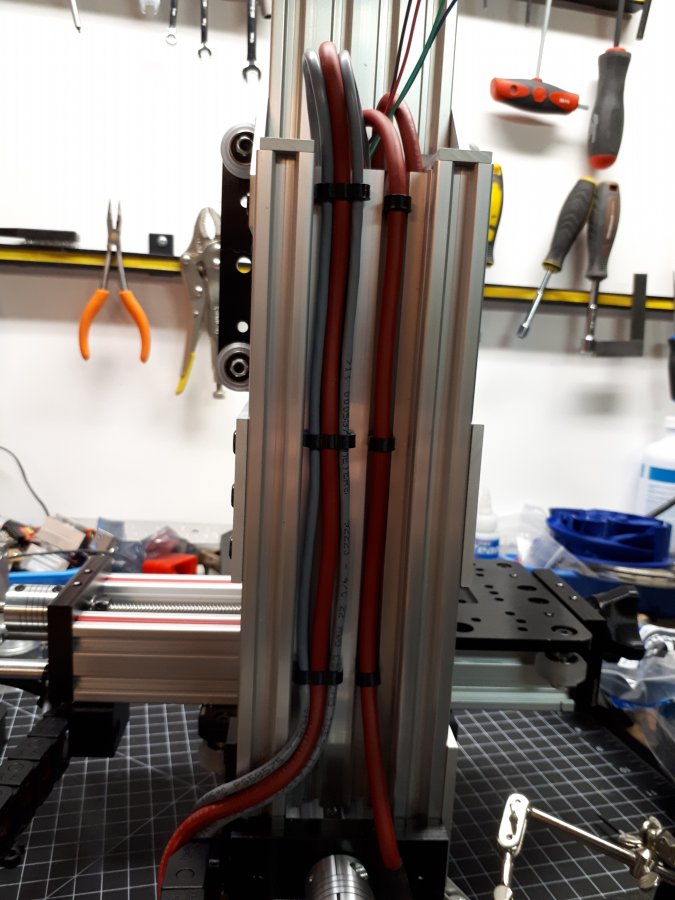

    Printed some wire management:

    Might you be so kind as to post the stl file(s) for your endstop switch mounts? Thanks!
